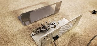

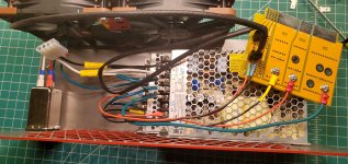

Howdy folks, it's been awhile. Time to regale you all with the progress of the Nova 1200 power supply replacement.

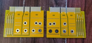

Forgotten Machines/firebirdta84 designed a passive interface board for the Nova's power supply for our development work. Nevets01 and I vetted his work, and each ordered a few for ourselves. My batch of them arrived mid-August.
Another good friend of mine designed a metal bracket in the spirit of the original in CAD for me, but modified the layout to accommodate modern power conditioning modules, and increase the opening for airflow. It was manufactured by sendcutsend using 0.74" mild steel. They also bent the part for me, as I lack the tools and experience to perform that type of fabrication.
Using abusing compu_85's battery tab welder, we spot welded some steel grating to cover the ventilation hole for safety. Then I gave it a coat of "prototype red" paint to make it very clear that this is not original. After that, I began installing Meanwell modules that would be providing power regulation, and wiring them up. An LRS-150-15 provides the 15V rail, and an RT-125A provides the 5V, -5V, and 12V rails. I added a pair of high performance industrial 12V Noctua cooling fans -- the highest airflow available for the 12V range. The 12V rail would be standing in for the rather vague Lamp Power rail that Data General documents indicate could be anywhere from 11V to 14.5V, so I figured it had sufficient amperage to run both a pair of cooling fans and the lamps without issue.
Surprisingly, I was able to get both of the 120mm fans in place using some brackets and a few pieces of meccano. It's a bit of a tight fit, but it fits! It was then installed in the chassis.
Bulb tests went well, voltages and ripple seemed well within spec, so it was time to reassemble and see how we did.
Initial tests seemed like everything was going okay, voltages were where we expected them, but nothing was functioning as expected, most notably the front panel. The 12V section of the supply seemed upset all the sudden, and was going into cutoff oscillation, and one of the bus signals was following it, albeit capped at 10V, when it should only be as high as 5V at best. Then we noticed it, at the expense of an oscilloscope probe:
Seems that we had gotten the labels on the top and bottom of the power interface board mirrored.
The main power signals (GND, 15V, 5V) are all present top and bottom on the power board. The other 8 contacts only exist on one side of the card edge connector. /Power Fail, MEM OK, 60Hz, Lamp Ground on the bottom, -15V, +5V OK, -5V, Lamp Voltage on the top. And we got them backwards... none of us caught the mirrored signal labels, and I was the first to power on and find out the hard way. The good news is that most of those signals weren't going to cause an issues. 60Hz and -15V were options I don't have installed. MEM OK and +5V OK are opposite from one another, and both were tied high with pull-up resistors. /Power Fail has its own pull-up resistor on the CPU board, so I didn't touch it. -5V was sitting where 60Hz should be, and it only goes to one specific card that was not installed at the time of testing.
That leaves Lamp Voltage and Lamp Ground. With those two reversed, the 7407's on the front panel that drive the display lamps were getting backwards voltage. The good news is that it's an isolated ground, only connected on the card edge connector itself. During my testing, trying to figure out what was wrong, I connected my probe ground mostly to the signal ground used by most devices. The last time, it was connected to what I thought was Lamp Ground, resulting in the probe conducting what was effectively a ground loop, and it released the magic smoke (see the FLIR image to see how irregularly warm it got). Once I realized that, I swapped all of the mirrored signals on the card edge connector, but lamps were acting real funky. The 7407's that drove all but one lamp had all been zorched by the unexpected voltage, so those all needed replacement. Good news is I had a pile of them, and I started replacing them and installing sockets.

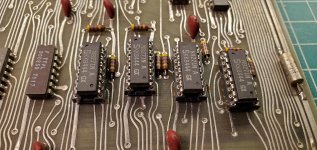

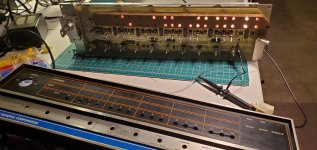

After that, it was a game of chasing any signals on the CPU board that might have backfed 12V (or rather 10V after the voltage drop provided by the 7407's). U2 (a 74LS74 that handles RUN/HALT control) and U22 (a 7404 for more status control lines) had both been destroyed, and were replaced with sockets and new chips. After that, signals like RUN, HALT, FETCH, etc. started working as intended, but things like the program counter would not.
Unfortunately, that was as much debugging as I could do prior to Vintage Computer Festival Midwest. I had to pack the system up in the car for the road trip, but we suspected that 4 or possibly 8 of the 8271's in the CPU had been damaged, but we weren't certain. I had no 8271's or 74179's to install in their place, so I went to war with the Nova I had, and a seemingly working power supply.

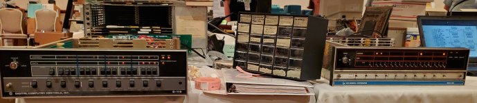

So, VCF Midwest 17 was a blast. I got the Nova all set up, and did a bit of debugging on the show floor on Saturday next to a very encouraging sight: Nevets01's DCC-116 running a fancy new power supply, made using the same Meanwell modules and card edge connector as mine. He was able to avoid the pitfalls I had pointed out, and had a working machine all weekend long.

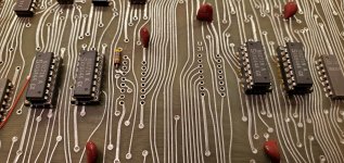

I spent some time trying to verify what parts had failed on my system, and eventually determined that it was indeed the 8x 8271's that had failed: U29, U28, U33, U32, U37, U38, U39, & U40. I spent some time hunting for spares (either the Signetics part number or the 74179 equivalent). Sadly, nobody had such an obscure old 4-bit shift register on hand. Everything else seemed to be alright though. Nevets01 was able to test 2 of my other 8K core memory boards to ensure I had operational memory, so that's nice. Forgotten machines brought along a spare Nova 1200 CPU board, but it sadly was broken as well, and in different, unknown ways.

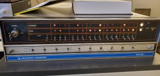

Once I got home, I was able to order some 8271's, and I got them installed yesterday.
After those were installed, I tested things like the program counter (which now works again). After installing a known good core memory board, I was also able to test the accumulators, and traversing/modifying memory. Right now, I'm noticing some intermittent and concerning behavior: Accumulator 3's Examine switch does not respond when it should, nor does Deposit or Examine. Run sometimes also will not function, and I suspect all of those either have to do with the machine restarting in an inconsistent state, or perhaps more failed or marginal logic chips that I've yet to find.
I was able to toggle in a simple Fibonacci number calculator program written by QuantX and test the program, which I am happy to say ran as intended. I connected up my Cassette I/O board and was able to run the serial parrot test successfully as well!

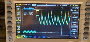

However, Nevets01 is noticing that same thing as well and pointed out something important: the power supply wakeup signals (MEM OK, +5V OK, and /Power Fail) are not coming up in the correct order on system power on. Both of us are just immediately asserting those signals high, rather than providing them in the proper order. We're investigating good ways to implement that logic at this time.

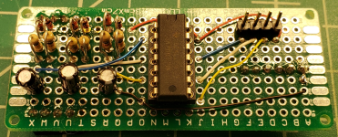

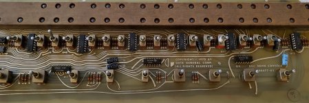

A friend of mine has designed a simple triple RC-circuit combined with Schmitt triggers to replace the power check circuitry of the original PSU. Here's my implementation of that design:

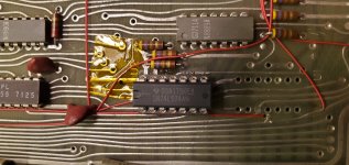

It takes the presence of 5V, and uses that to provide 5V OK, MEM OK, and /POWER FAIL in the right order with delays between each signal, culminating in the CPU coming up cleanly, and (in theory) halting the machine cleanly on an unplanned power failure.
I've got it attached to the top of the card edge connector in the power supply, replacing the pull-up resistors I had previously installed.
It's drastically improved the functionality of the front panel, removing most of the unresponsiveness from switches. Deposit seems to be the only switch that isn't responding consistently, but it does improve once the machine is warmed up. Everything else is playing nice for now, and using the Nova feels much like it did when the original PSU was in good working order.
