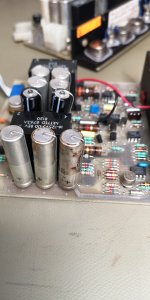

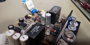

I had the same with my low profile PDP11/34 and its H777 power supply. I never switch on these things before checking the mains circuit and power electronics. I ended up replacing all 14 electrolytic capacitors. But it was rewarding to have a working PDP11/34 :love:
