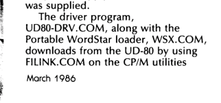

Just realised it looks like I don't have the correct driver program for the UD-80. It should be called 'UD80-DRV.COM' and the one I have is for the DS8 and is called DS8DRV.COM. That could be a problem....
I should have read that review properly! It actually says that the driver downloads from the UD-80 itself using Filink!
Just need the right serial cable! 😁

Here's the documentation I stumbled across in the original manual that the donor had supplied but that I had not looked at (because I'm an idiot)! 'Handshake In' is DTR and 'Handshake' Out is CTS which are the connections I was missing...
