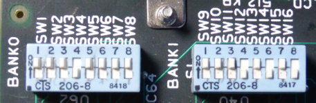

Case #1 is suspect, and I think this could be switch settings on the card.
So,
- 512 KB of base/conventional RAM on the motherboard.
- 'IBM 512KB Memory Expansion Option' set to start its RAM at the 1 MB address mark.
- GSETUP used to configure CMOS SETUP for: base/conventional=512K, expansion/extended=512K
On the 'IBM 512KB Memory Expansion Option', the switch settings would be set per [here]. Step 1 done, then row 1 of step 2. In my 5170's, I have 512 KB of extended memory, provided by one of these cards. A photo of the switch settings follows.
And in case of 'dirty' switches, try adjusting each switch between the on and off positions a few times. And something that we have seen on these forums is a switch that has not been pushed 'fully home'.

Your switches are slide and mine are rockers; never-the-less they could be dirty, I don't know. I can flip them several times and retest to see if there is a different response. I have the users manual, which showed the switch settings for one 512-KB board placement that matched the table settings you pointed out. If the response is the same then I'll have to presume that the first chip set (since their are a pair) are defective. Is the chip pair U30 from Bank 1 or U51 from Bank 0 the cause of the error, both are labeled 1 in the following link: https://minuszerodegrees.net/5170/cards/5170_memory_board_512K_ram_layout.jpg ? I also used the GSETUP with the 512 at the base or conventional memory and the 512 extended memory. That's how I got the first set of numbers similar to the Landmark picture you showed.

The photo in post #91 reveals that you have the switches set opposite of what they should be. Years ago, this was happening often enough that I created the web page at [here].

Modem7, you provided a link to the minuszerodegrees picture of the switches for the IBM Extended Memory Option card, which housed the added 512-KB memory. This picture showed the same rocker switches used on the card and the one sentence that was the game changer for that card was the switches were all off even though the red markers were all in the on position. So with that in mind, I asked myself, "Do I have these switches backwards and the answers was Yes, I do." When I flipped the switches in the opposite direction and placed the card in the machine, I got another memory error where the machine recognized the added 512-KB of memory. After I corrected the extended memory, the machine rebooted with 1152-KB of RAM. The picture of the rocker switches were the key element in this whole effort with the IBM Extended Memory Option card.
I don't know if the switch settings are reversed on the Cheetah card. I will have to address this at a later date.
Those red bars/markers on switches have misled people. In the photos at [here], originally, the switch that has red bars didn't have red bars on it. Many years ago, a member got confused by the red bars on his/her switches, and to help other people, added red bars to the photo, and sent to me the revised photo.
