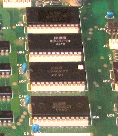

10.) Knowing that eproms are UD9 = F000, UD8 = E000 , UD7 = D000, UD6 = C000 we know that kernal is UD9, editor is UD8 ( which is 2K not 4 ) and 7,6 are the basic so that was the order
11.) Yes I was to write all this after the tea then my mate says "hey did you know that in that forum that guy said .. "
12.) .. *NGH* ..
All this was around slot '14' or so in the list of things "after the tea", being in Wales here we do not do anything in the morning before to morning tea :cool:
And before all this there normally is the 'feed the sheep' part and bring the dog out, we are sub zero temperatures here so the dog has to stay inside home during the evenings.
I hope this answers ;)
Despite being a computer geek and spending already something around 12 hours a day in front of this PC ( working ) and even more "doing other things" ( like fixing this PET in fragments of time ) I could be not 'super fast' in keeping stuff up to date and especially in a forum like this I want to be sure that what is write is very correct and detailed as necessary.
The ROMS anyway are called :
basic-2-c000-901465-01.bin
basic-2-d000-901465-02.bin
kernal-2-901465-03.bin
edit-2-n-9014467-24.bin
As I said I managed to read the old roms and their contents seems to be identical to those files.
By applying a 'CSI tecnique' ( i.e. zooming on a high-res pic I took immediately after I cleaned the PET before to do anything else on it ) I can tell you that the roms where in fact in its original order as that :
UD9 = 03 ( which is in fact kernal at F000 )
UD8 = 24 ( which in fact is the editor )
UD7 = 02 ( which in fact is basic D000 )
UD6 = 01 ( which in fact is basic C000 )
( this is why I take pics before to touch things in case I forget how they were )
So again telling that the order is F,E,D,C

Originally Posted by GilesGoat
I used the .bin files with the same numbers like in the ROM ( i.e. like 9014465-03, 01, 02 and 901447-24 .bin ) putting them in the order the should be.
We all know which ROM does what and where they should be and didn't need that explained (several times) ; what we didn't know is where they were plugged in in your board. A simple
UD6 - 901465-01
UD7 - 901465-02
UD8 - 901447-24
UD9 - 901465-03
would have been sufficient. Thank you.
