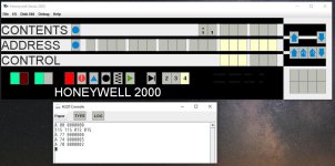

... I've run the little program at 8-J on Doug's simulator. ...
That's an interesting little "program" to analyze. The H3200 must have had different control register assignments, at least for AAR, but I was able to get this procedure to work:
A 00 0000000
115 115 015 015
A 77 0000000
A 67 0000003
A 70 0000002
A 00 0000000
And looking at what it does, I see that it never completes execution of the first instruction. It fetches the LCA opcode and starts executing with AAR and BAR as previously set. Because of the overlapping fields, 015 (LCA opcode without WM) keeps getting copied ahead of the AAR and so the instruction never sense a WM to terminate the copy. The CPU just keeps copying 015 over all of memory forever. You have to manually STOP the execution phase, at which point memory is filled with 015. If you were to RUN again at that point, you'd never complete the fetch phase since there are no WMs in memory anymore, which would explain the simulator exception.

... I thought it filled memory with all 0s though, so I checked the first 64 memory addresses in your simulator (starting at 0 and using +1 to increment), and they are all 0s (pic of what I ran attached). ...
Ah, yes, you are setting CR 74=0000003 which is not a "valid" CR on this machine (it is not used by the CPU). I assumed that was meant to be AAR so I used 67 instead. If I run using 74 I also get memory filled with 00, but that is because AAR just happens to be 0000000 at the beginning and it quickly wraps around backward and, on the simulator, memory powers-up to 00 (but on a real H200/2000 that memory is core and will power up with whatever was last left in it) I thought about trying to emulate "real core memory", but have not thus far. So, I think the only way to get deterministic behavior on a "real" system is to make sure AAR is getting initialized (and memory is filled with 015). There's probably a way to re-do the "program" so that it fills with 000, too (perhaps as simple as "115 115 000 000").
It appears that some systems assigned AAR to CR 74 and others assigned it to CR 67. I haven't found any details on the 3200. The "Models 2040 through 2070" and "Models 200,1200,1250,2200,4200" documentation I have found show AAR at CR 67. At least as far as the variant character used in the LCR/SCR instructions. I have assumed that the front panel operates with the same codes/addresses as described for LCR/SCR.
I did sort out my confusion about CR 67 vs. 74. I read the table with the LCR/SCR instructions to mean that AAR was 67, but upon closer reading I see that 67 is a temporary register used to keep a copy of AAR during the LCR/SCR instructions. It would seem that AAR was 14 on very small H200 system (max CR 17), which seems to translated to 74 on larger systems (max CR 77).
I'm guessing Rob is building a smaller config, probably using CR 00-17. But given the likely 4-bit addressing, one could probably enter CR 74 on these smaller systems and get 14 when the control memory is actually accessed.
