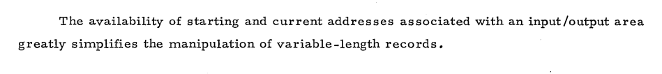

I guess I was talking about the read/write channels, specifically the things that are using CLCx and SLCx registers.
The reason I believed they were accessible from the front panel was for debugging. After a peripheral operation, which might end prematurely, being able to examine memory where the I/O took place would be useful. These registers contain the addresses - at least the address indicating where the operation started and ended. Similar to the BAR and AAR, they might be invaluable when trying to figure out what went wrong.
Even within a program one might need/want to access those registers, for example to compute the actual length of a tape record after reading. I haven't found definitive documentation to this effect, but I assume that the tape transfer ends when the record gap is encountered on the tape, so the program might need to check whether enough data was transferred. In the Unix world, one also needed to check for 0-length records which indicate EOF. I'm not sure if anyone used that convention on the H200 (I do see references to records that contain " EOF" for that purpose). While I haven't seen any reference to this capability in documentation, one could theoretically use these registers to handle variable-length records (on certain media). For that matter, input from the console typewriter might need that (from what I can tell, pressing return ends the input operation).

I don't think I've seen the H2000 manual but this reference is to use of the register values within a program where the relevant channel can be identified. Assuming that a large machine running many programs would be assigning channels dynamically one wouldn't know which channel to look at and also one would have to stop the whole machine. I would expect peripheral failures to be investigated by diagnostic programs rather than manual use of the control panel.

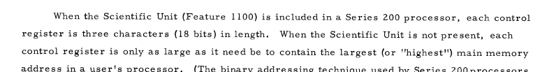

Regarding the photo of the front panel with 18 "Address" buttons, I wonder if this might also influence the number of buttons there:
i.e. if one had 48K core but added the Scientific Unit, did that warrant a front panel with 18 address buttons?

I don't think I've seen the H2000 manual but this reference is to use of the register values within a program where the relevant channel can be identified. Assuming that a large machine running many programs would be assigning channels dynamically one wouldn't know which channel to look at and also one would have to stop the whole machine. I would expect peripheral failures to be handled by diagnostic programs rather than manual use of the control panel.
I would have believed this was done under "controlled circumstances". In a "bare" program running on the machine, the program knows when the channel is re-used. In the case of things like OS/2000, the interrupt handler that "completes" the operation would grab these values before releasing the channel. Either way, typically these registers would be read right after the PDT instruction finished, before any other one was issued for the same channel. This is fairly common for operating system code.

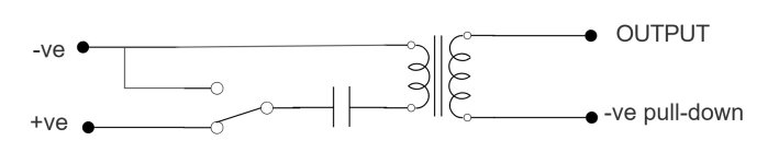

Moving on ... I think I've worked out how those one-shot buttons with the mysterious blue boxes function, having detected capacitance across the input terminals, inductance across the outputs, fine wires inside the boxes and the microswitch contacts being connected to both input terminals. I have also now traced the wiring to them inside the control panel which supports this analysis. It's evidently a pulse transformer circuit.

That makes sense. from your photo of the assembled panel with the back open, the "one-shot" buttons all represent functions that are strictly one-shot in nature - i.e. a "steady ON" would likely cause undesirable repetitions or other side-effects. Like the "DISPLAY+1" and "DISPLAY-1" buttons - it would be infuriating if one kept getting multiple "+1" or "-1" actions from a single press of the button. But the "DISPLAY" button would not suffer from that and so it does not have the one-shot module.

Actually I thought it was a belt and braces approach (is that idiom too English?) as the logic circuits to which these switches are attached (Now that grammar is just English pedantry but I enjoy using it.) all appear to have their own lockout mechanisms to stop repetitions anyway. For example in the DISPLAY +1 and -1 functions the register is only allowed to be modified once while the display signal remains high.
Of course it was easy to guess that they were one-shot buttons as the parts manifest states that the panel requires five one-shot switches and there are five blue boxes. What I don't know is what supply voltage is needed to operate them, so that will take some experimentation.

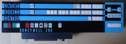

Curious, your photo shows 6 "blue box" switches (DISPLAY+1, DISPLAY-1, Address Mode, RUN, INSTRUCT, and BOOTSTRAP).
Seems odd to go to the trouble of adding the blue boxes to switches if the logic is already one-shot. Perhaps it's as simple as the logic was sensitive to switch "bounce" and the blues boxes would eliminate that.
So it does. The explanation I have found is that on the parts manifest there are one-shot buttons mentioned in two places, five of one type and one of another. I must have noticed this originally but forgot about the extra one. The only difference is that the odd one, which is used for the RUN button, also has a normal microswitch alongside it whereas the other five only have the one-shot switch. This difference is almost impossible to see in that photo. In fact in my control panel one of the other buttons also has two switches but one isn't used, so maybe they ran out of the ones with only one and substituted a double one.
I'm unsure what purpose the extra switch on the RUN button serves as it is wired to another on the STOP button and they are routed to the power cabinet connector, not the CPU connector, so there was evidently some logic in the power cabinet that was somehow affected by the STOP/RUN operations quite separately from the CPU. If I can't find out what that logic was for I can safely just ignore it as I will be making up my own power supply units.

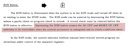

One possible clue to the extra connection form the RUN switch (an implied connection to the power supply):
I admit I'm not entirely certain what that sentence about overriding the AC and RESET DC OFF switches actually means. But having never operated one of these, I have nothing to draw from.

Thanks for that observation. From the wiring I suspect it means that the OFF buttons are ignored if they are pressed, so one has to stop the CPU from running before turning off the power, which makes sense. What seemed odd to me was that these buttons alone do not indicate whether the CPU is running or not as the machine may have halted itself, in which case even though the stop button was lit the power off buttons may not have worked. My field engineer friends may be able to recall exactly how these interlocks worked.
There were certainly some interesting interlocks wired into the power switching. For example, if the AC ON and AC OFF buttons were pressed simultaneously by some moron then the OFF button overrode the ON button. The same applied for the DC buttons. Pressing AC OFF or DC OFF while a program was running would have been equally moronic.
In his description of the design of the H200 its chief designer stated that, it being a cheap machine intended for the bottom end of the market, the people who used it probably wouldn't be used to working such complicated technology, so the design was aimed at being simple and foolproof (hence the clean design of the control panel without any unnecessary elements to confuse us simple folk). He wrote this in a personal document that was not intended for publication but his daughter has given me permission to quote from it in the appropriate context.
