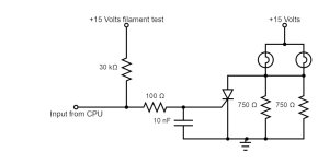

Having determined that many of the components on the driver boards are actually part of separate circuits, the SCR driver circuit is now ludicrously simple. See below. Clearly there are no gate turn off negative pulses involved, so the only way that the circuit can function is by being supplied with a fluctuating DC supply, e.g. raw unsmoothed rectified AC, to turn off the SCR. This would tend to synchronise the flashing of the lights with the mains supply but the actual patterns would be complex as a result of the filtered high frequency digital CPU input gating the SCR at varying points throughout consecutive half cycles. No doubt this interaction gave the control panel lights their distinctive appearance when the machine was running, something that people have mentioned in their recollections.
When the INITIALIZE button is pressed it feeds +15 Volts from the same light supply into all the filament test inputs with the result that all the lights (at least the ones that actually work) are forced on.
