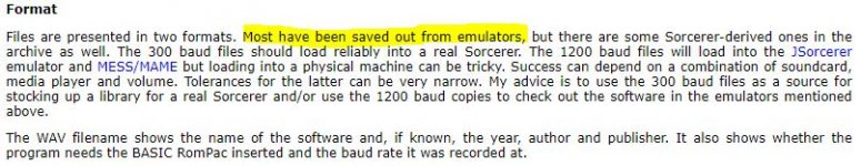

Welcome Rob, and thanks for sharing your findings. Tezza’s software library is one of a kind. One thing to note is that the 1200 baud versions are really suitable only for the MAME Sorcerer emulator. Actually I am surprised to hear you managed to load one of them. On a real Sorcerer you can use the 300 baud versions. They should load reliably.
The monitor defaults to 1200 baud. To set it to 300 baud you need to enter
SE T=1
in the monitor.
Of course you can then switch back to 1200 baud (SE T=0) and save the program for future re-loads.

Thanks dutchacorn for your comments. You may be right, perhaps the file I loaded was at 300 baud, I can't remember for certain. As I mentioned, I'm turning my attention to a digital interface to the UART, similar to what ClausB built with Teensy. I posted just this afternoon on a Sorcerer thread, a few more details about the Python script I wrote to demodulate the WAV files to a binary format. I also posted the script to Github in case you are interested.
I don't concur with that view. All the software I have contributed to Tezza's site has been saved out of a real Sorcerer and painstakingly tested to ensure that it will load back into a real machine at 1200 baud. Tezza's original rationale for setting up the site was because real machines couldn't load a lot of the files circulating on the Internet for use in MAME - and this was actually leading people to conclude there was a problem with their Sorcerer.

Thanks for that, I was actually under the assumption that all of the 1200 baud files were saved from an emulator. Tezza confirms that most are. In my experience WAVs created @ 1200 baud from MAME cannot be loaded into a real Sorcerer. But I have not dived into what causes the issue.
All the WAVs that I sent to Tezza were 300 baud only (saved from an original Sorcerer). I assume that the 1200 baud versions of those were created by Tezza using MAME.
