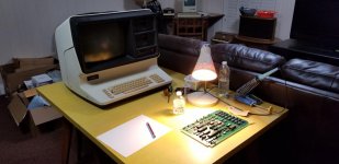

okay, have cleared a workspace for the machine, with access all around and power. It's a bit heavy for the table but it should do. Can get back onto it now..

However, I have managed, for the first time in two years, to gather up something resembling a work space (now in my new house, woo!) and have dumped the Lanier into a table, pulled the CPU card out and have made a start on making a circuit diagram.
I've also got a logic analyzer on its way, which may or may not assist in the undoing of this device.
