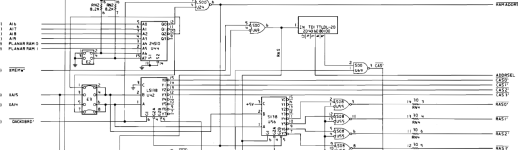

Sorry about the delay. Looking over my pin-routing, The RAS and CAS are fed to the memory ICs by a 157, a LS08 (AND gate), and a 138.
I'd have to check whether that matches up with any schematic I've looked over before. (If this feeds through the same types of logic gates present in those ICs)

Open up the 5150 and 5160 service manuals and look at sheet 3 of the schematics for both of those machines: What you need to know is what is *immediately upstream* of the '138s. (There should be two, one that directly supplies the CAS lines and the other that supplies RAS through the '08.) The input and enable lines (1,2,3 and 4,5,6) will connect to some combination of address lines and an address decoder. That address decoder is what you need to understand. Full stop. There are many things it could be, the 5150's schematic is the "simple" version and the 5160's is a fully programmable one. Diagram everything, accurately. There is no particular reason the Sanyo's address decoder should match either IBM machine's particularly closely, there are *many* ways this to skin this cat and you need to understand what Sanyo actually did.

As laboriously gone over earlier, U84 on this snippet from the IBM 5160 motherboard schematic is one of the (important) differences between this board, which supports 256kbit RAMs, and the (later version of) the 5150, which only supported 64kbit. Again, rehashing what we already know, it's a multiplexer with two used inputs, XA16 and XA17, buffered versions of the CPU's A16 and A17, and the output derived from them is MA8, which is connected to pin one of all the memory sockets. The input "ADDRSEL" is used to switch which input appears on the output depending on which part of the RAS/CAS cycle we're on. Two address lines is two bits, the number of possible combinations in two bits is four, so if everything is working right the addition of this part is what lets the same sockets hold four times as much memory; a line that's unused on 4164 chips turns into (effectively) two additional address bits. This means, tada, the same array covers 18 address bits (2^18, 256K, instead of 2^16, 64k).
So... obviously, this is a problem if A17 isn't connected to this multiplexer; it means that either RAS or CAS will always present the same value to A8, and this reduces the total size of the memory bank to 128k. If the memory *addressing circuitry* were set up to expect 256k in a bank this isn't a "self-healing" problem, one half of the 256k range of that bank will just address a duplicate of the other because of the stuck bit. In some hypothetical situation where you were sitting on a pile of 41256s that you knew all had the same half of the chip "bad", sure, you could take advantage of this by going ahead and populating those chips into banks and setting up the address circuitry accordingly. (Per your reference, they actually did this with half-bad 16K 4116 chips back in the late 1970's; they sold them as "4108s" and they were used in Commodore PETs, among other things.) But I absolutely 100% don't think this is what's happening in your Sanyo. Full stop.
If you have a logic probe or oscilloscope I would by all means suggest you probe the "XA16" and "XA17" inputs on the '158 multiplexer you added to control A8 to see if they're changing; if you see XA16 pulsing and XA17 not pulsing then you know, full stop, that the 256K banks will not work, and that's useful information, but whether they're pulsing or not I'm am positive that it doesn't matter, your memory decoder isn't set up to make use of the full capacity of these banks. Even if everything is working here I think you're only set up to use a quarter of the capacity of the 256K banks, the only thing having this circuitry working is going to change is which quarter you're using in each bank.
Here's another screenshot from the 5160 schematic. Completely forget about the memory array right now, full stop, other than this: Each row of sockets are all wired in parallel except the CAS/RAS lines. It is the CAS/RAS line activity that triggers read/write/refresh cycles on the chip:
See how A16-A19 feed into that 24S10 chip (and some lines that go to DIP switches and jumpers, but we're ignoring those right now), and three control lines come out. The 24S10 PROM programmed with a bitmap of information so for a given memory address (with 64K granularity, because it only sees the top four address lines, letting it break the full 1MB of address space into 16 chunks) it activates some combination of output lines. The first, "RAMADDRSEL", comes on if ANY memory on the planar is supposed to be active; it controls the buffer in front of the memory chips which asserts control of the bus if it thinks the memory chips should be answering the bus request. The other two lines coming out of it are a two bit bank select. Based on the memory address one of four bank numbers 0 through 3 will come out of these lines. It is the programming of this PROM that "knows" if a bank is supposed to have 256k or 64k in it, and what areas of the memory map that bank is going to cover.
The bank output from PROM goes to that pair of LS138s labeled U42 and U56, which decode the "multiplexed" binary number into a singleton CAS0-3 or RAS0-3 signal. They're 1-of-8 selectors (of which half of each is being wasted, turning them into 1-of-4 selectors) so only one memory bank will get an active CAS/RAS at a time. Thus... and there's the part I keep repeating: It doesn't matter if you fixed up the memory bank so it's "256K big" instead of "64K big" if this part of your Sanyo doesn't know about it. As it came from the factory your Sanyo was set up so it broke the first 256K of the 1MB address space into four 64K chunks, and activated a separate CAS/RAS pair for each of those chunks. If you haven't adjusted that and just substituted 256K chips in the bottom two banks, again, even if everything is working perfectly in that area here is what your memory map is going to work out as at a hardware level:

Unless I missed the part where you redid this part of the circuitry all the fooling around in the world with the memory banks themselves isn't going to change when they're enabled. Now, sure, in some later computers the computer can figure out itself what size memory chips are installed in a bank and switch to a memory addressing scheme that suits it, but I absolutely guaruntee your Sanyo doesn't have that implemented. (The 5160 doesn't either; it can guess if a bank is populated but it can't change its addressing behavior if you stick the wrong size into a bank.)
