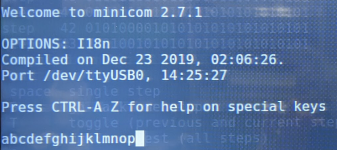

I had some time to work on #435 today and got to show the machine off to a friend's dad who used to work for Control Data back in the day.
As you may recall, we're having some weird issues with the serial.
Next time, I'll try the program @DougIngraham suggested in his post above. Today though, we ran two "punch in programs" we had on paper here. They are:
When we run that program, whatever we type in minicom appears on that line, and we can see the last character in the accumulator (plus the 8th bit of the byte is always lit). When we hit enter, it returns to the beginning of the line. Here's an example pic of the output:

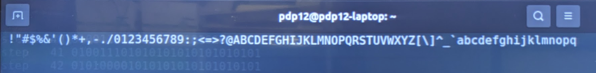

Next, we tried this console print test:
When we run that program, it appears to print the full character set (on one line) in a loop. This is what we see in minicom:
One thing that's weird is that minicom gets completely confused by this and I am unable to quit minicom normally, even after stopping the program on the PDP-12. I'm not sure if this is normal, or not.
That seems OK. A Control-J should probably line-feed.
That's almost right, but the line feeds didn't happen. On my terminal emulation each repetition is on a separate line, since there should be a bell, a tab, a line-feed and a carriage-return which should arguably be detectable.
I wonder if some special (non-printable) characters cause minicom to lockup.
Yeah, given that you're probably iterating through the entire ASCII set in order, you're going to start at the control characters. Something is going to send an ESC and then follow up with other control characters that may tell whatever VT102 emulation you're in that it's time to go into a special mode.
