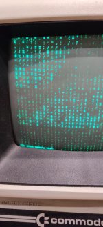

Seems as soon as I fix one issue with this machine another one crops up. Now the vertical hold has gone and so I get a repeated screen. At one point in the test the screen does go haywire and display random characters which seem to be redrawn so fast the bit patterns change to other characters partway through the raster scan.
This sync issue could be the faulty wires but I'm leaning toward the CRTC due to the randomness and the fact I have new SRAM and the tests pass. My guess is the CRTC is generating the wrong addresses but I don't have a CRTC chip to try (my other PET is a 2001) I'm not sure if putting the scope on it will tell me much since the display is sort of working.
The attached picture looks worse than with the naked eye. You can actually see the "32k dram memory test" several times down the screen but due to the headache-inducing flicker the camera missed it.

The PETTESTER obviously checks that the CPU can write to (and read from) the video RAM Ok, which it obviously can.
This leaves the CRTC and the video address multiplexers (UC8, 9 and 10).
It could be worth quickly checking the TAn signals from the CRTC to the address multiplexers to see if one (or more) are garbage.
The address multiplexers are known to go faulty.
Is the CRTC in a socket or not?

Looking at your suggestion, Dave, I put my scope on UC8, UC9 & UC10 and all the outputs seem to be outputting something. Nothing looks stuck.
I'm trying to get my head around what is going on. When I use the PETTESTER ROM the screen is rolling and filled with garbage but the RAM tests seem to be OK.
When I use the original ROM I get some garbage but a solid display. It's the same bit of screen with the same spurious characters.
So, I just tried an experiment. Starting with the initial screen which displays correctly, first I scrolled the screen down and as I did so "ready." was scrolled up 1 line but was replaced by "r@a@y@" and also some of the garbage which scrolled up was also changed. I continued to scroll everything and the screen eventually cleared.
Next, at the bottom left of the now cleared screen I typed a row of "q" characters. As I did so every other one caused a "!" character to be printed in the centre of the screen spaced a single character from the previous i.e.
qqqqqqqqqqqqqqqqqqqq
I pressed cursor down to scroll this and the screen changed to this:
qpqpqpqpqpqpqpqpqpqp
So there appears to be a stuck lower bit in even character positions in certain situations plus some odd character copying to areas of the screen memory. Scrolling this down caused the lower row of "!" characters to scroll up by 2 lines each time so it got further and further away from the "qp" line each time. I'm not sure if this is just one problem or more.

I'm getting consistent garbage printed in the lower half of the screen depending on what is appearing in the upper half of the screen. The garbage is every other character and changes consistently with the content of the upper half of the display. For example, typing a row of 1's will display
[space]!
and 2's will display
[space]"
My suspicions are UC8, UC9 and UC10 as Dave mentioned previously although none of the outputs appears stuck. I'm suspecting one of the chips is outputting when it shouldn't. I don't have any SN74LS157N chips in my spares box so it's going to have to wait until after the holiday.
The other possibility is that it's when the CPU addresses the display RAM. I'm trying to read the schematics but I can't see where this is done so if anyone can explain I'd be grateful.
The final possibility might be the CRTC. From what I understand it generates the display RAM addresses for each frame so it's possible that this isn't working properly and so in the lower part of the screen it is addressing the same part of RAM as the upper part although I'm confused as to why the characters are different. Perhaps there are multiple problems. I don't have spare CRTC chips but I do have an Amstrad CPC or 4 lying around - can a borrow a CRTC from one of those?

Don't forget that the RAM is interleaved on the screen. The first character position on the line is EVEN RAM followed by ODD RAM.
It could be a duff RAM chip or the associated data latch.
Is your 'duff' character the first or second position on each line?
If it was an address line, it shoukd make both odd and even both faulty. You could also have two faults...

It's the second character so that sounds like the odd RAM addressing. However, I can't fathom what's going on. Looking at the PETSCII table it appears that whatever character I type on an odd RAM address the 2x version of it appears in an odd RAM address lower down the screen. e.g. 1,a,q->!, 2,b,r->", 3,c,s-># and so on. This seems to be a decimal shift but makes no sense from a binary perspective. Just scratching my head over that as a mental exercise!
BTW, the display RAM was bad and I replaced all 4 2114s previously.

In the meantime I swapped UC6 and UC7 and I get the same fault but different characters. I think that might mean my new RAM is bad.
I would actually swap UC6 and UC7 (ODD) with the other pair (EVEN) to see if you can make your problem move over to the EVEN bank.
After a long, long time I'm returning to trying to fix this PET. On first power up the screen started with some garbage in the same places are before then the whole screen filled with random characters. Subsequent power cycles just kept the garbage to the usual garbage in the lower half of the screen. Following Dave's advice above I swapped UC4+5 with UC6+7 and I saw the similar symptoms. Then after a minute or two the screen filled with garbage again.
Checking the before and after swap screen output I could see the problem shift from the even to the odd columns. After a bit of swapping I found that one of the new RAM chips was the problem. I'm just erasing an EPROM and then I am going to burn a fresh diagnostic ROM and check everything.
