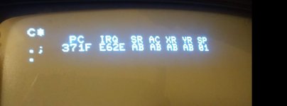

I checked out some signals at the VIA socket and CS1, nCS2, RA0, RA1, RA2 & RA3 look OK. Checked some other signals and again cannot spot anything... Anyway I put the board back into the chassis and removed all PIAs and the VIA, I then replaced the PIA#1 with a replacement and to my surprise it would not boot to anything except blank (but a soft reset will get it to a flashing prompt) very much like behaviour seen before... anyway... My ROM board has a number of images so I switched to 'Basic 2'... and the behaviour is a bit different... I get a screen with some hex numbers and occasionally get garbled characters and the hex... with a soft reset it goes on to a good flashing cursor.
and
or
or

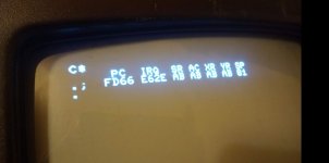

The FD66 variant seems repeatable 6 times out of 10
And another observation.... when the ROM SET which includes the PETTESTER is selected the PET starts from cold... every time...

The ‘hex numbers’ are TIM (the machine code monitor), however, the random characters on the screen are not correct.
The ROMs check the DIAG pin on power-up and (if pulled low) enters TIM rather than BASIC.
Removing the PIA associated with the DIAG signal could cause the CPU to misread the DIAG pin and enter TIM as a result. However, in this case, TIM should be operational (the manual is available on the internet).

In the screen images above one of them shows a PC of 371F which clearly doesn't sound feasible.... and the screen images show corruptions... which are interestingly striped... suggests to me the data bus is contended during the screen clear so an attempt to write a $20 actually ends up writing something else.
I'm confident in my PIA since it passes the PETTEST nicely by showing the keyboard scan.... so I think that suggests data bus contention early on... but that could be many many things...

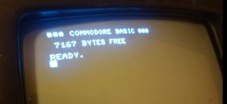

The current state is I have all ROM and RAM replaced, buffers at G5 and G6 are removed (now empty sockets), PIA#2 and VIA#1 sockets are empty but things are looking pretty good.
Boots every time to... (with flashing cursor and keyboard working)...
She lives!

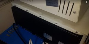

Away from the electronics I have a physical issue with the case... at some point in its previous life the bracket at the back has been bent so the screw holes and bracket do not line up...
It's like it was bent back on itself once and the top case bent rather than the hinge.
Should I drill the rivets and try and bend it? I don't think I could rivet it back since my hand rivet gun would not reach... nuts and bolts?
I'm not a big fan of those programmers, turned logic tester. In circuit function is always the best indication. I saw something funny in your reset schematic but didn't say anything because I couldn't figure how you were connecting it.
Anyway, it is looking good. Another pet is alive.
As for the bent metal, I suspect it was dropped. Does the hinge work freely? If so, it may recover by applying force in the right places. If not you'll have to drill the rivets and work on it when apart.
