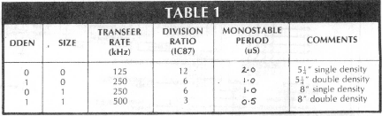

ok, the repair has stalled on the floppies.....
This cortex has two Canon MDD110, which seems to be the much less popular single sided version of the MDD210.
If I use the PC serial app to upload the SAFORMAT app, no matter what I select I get a flash of activity on the floppy and it immediately quits out with an unable to format error. There's no seek or head movement on either floppy drive. I've tried a number of different disks. I've also connected up the drives to a greaseweazle and that seems to be able to write to the drive fine.
If you type "boot" the drive does head to track 1 and bounces about there trying to boot ... but as I don't have any actual disks I have no idea if it would actually boot, and I don't know what profile I'd need with the greaseweazle to write one (I've tried a couple of different configurations and they write but don't boot)
Interestingly the "size" jumper was set, which the instructions say is for 8" drives, but I've desoldered this and it makes no difference.
Any advice is welcomed as I don't know if I have a config issue, or a hardware issue with the cortex or the floppies. I do have some other spare drives and a gotek which I've had no luck with, but again I don't know how either the drives or the jumpers on the cortex should be setup...

I've used a scope as per the trouble shooting guide and can see an approximately 2u signal on pin 5 of IC70 and pin 26 of IC76 and I can also see a low signal on pin 5 of IC76 to suggest it's seeing track0 ... but that's as far as I got with the "probing"

What floppy controller IC do you have? The original TMS9909?
With the GOTEK mode set to MFM, you have the DENSITY jumper fitted?
Any better if you change the bps setting from 256 to 250?
yes it's the TMX9909
The Density jumper is hard wired on.
If you change to 250bps the Gotek errors on the disk image. I've messed around with most of the basic options like rate at 250 as well.
It would be good to get a known good Gotec/flashfloppy config working..... assuming you can
It's not totally clear, but it looks like the DENSITY jumper needs to be *removed* for DD (which gives a logic 1 input to IC63). So if the DENSITY jumper is hard wired on, that gives you SD - might want to try adjusting your GOTEK config accordingly. The SIZE jumper should be fitted for 5.25", which I think is what you found. The table of jumper settings in the documentation (Table 1 in Part 2) is wrong in the original documentation, but corrected in the Cortex II doc (copied below). A '0' is jumper fitted to pull the signal down to ground. A '1' is jumper not fitted so signal pulled high through a resistor.
Just been trying out my two ex-BBC Micro dual floppy drives with my two Cortex boards, and none of them work - on doing a BOOT the drive 0 starts spinning but is not seeking to track 0 as far as I can see. And the heads are dirty and scraping the magnetic coating off the disks. ;-(
I gave removing the size jumper a go, but it's made no difference. If you try and run SAFORMAT no matter what you select the minute you try and format, the drives spin up, but the program has already displayed
Unable to format track
formatting aborted
The drives spin and lock but only for a second then unlock (physical disk lock) but no head movement.
If you BOOT then you get the head movement but it just bounces back and forward looking for the first track to boot .... so the boot process at least looks like it's working, but I have no boot disks. My gut feel though is there's an underlying issue with the cortex. It's just annoying as I don't know if the cortex has an issue or both the floppy and gotek have issues, or the all have as I've not seen any of them actually working in this setup.
I'm getting a slightly different issue; I can get through the SAFORMAT process, the disk head moves across 80 tracks and looks/sounds like it's formatting, etc and the program ends. Then I run the DISKIMG program, all looks well, but when I try to run install the image "Recovery Utils 80SSSD.dsk" I get an immediate "Disk Write Error". Anyone had any experience at this point please?
You're getting further than me. There is a section in the guide for writing the floppy that states you need to change the density setting to read the disk. Is there any possibility you also need to change to write it?
I followed the trouble shooting steps in the main document regarding the 2us on pin 5 of IC70. I even installed a pot to see if changing the interval made any difference to my issue, which it didn't.

As for the Density and Size jumpers, both mine are in, as per Stuarts posting above. I believe the jumpers are only read at power up and Reset. They can be over-written by software, but I don't know if the PC CommsUtil program does over-write them.
