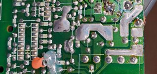

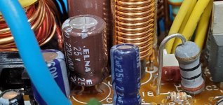

I think I've decided not to recap this power supply, at least not at this time. After disassembling I was unable to find any traces of leakage, even on the Elna capacitor (maybe I should just replace this one, it wouldn't be difficult?). Here are top and bottom side pics along with some additional ones. Please let me know if you see something I am not (brown stuff on the bottom is just flux from the manufacturing process).
Elna capacitor:

All of those capacitors in that supply of that brown color are ELNA, you can tell by the shape of the safety vents on top. If you ever see that style of safety vents in something, it’s ELNA. No visible signs of leakage is good - that means your recap job will go easier as there will be no mess to clean up.
I completely understand leaving something working alone, but you just can’t trust any ELNA caps nowadays. If you wait, that supply WILL die, and then you’ll have a nasty mess to clean up to boot.
Thanks for this information. With it I think I'll go ahead and recap it. Now to find the time.
