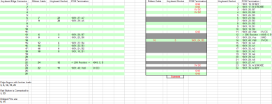

I need to sit down and figure out where the pins on the keyboard socket are going, then try and piece together something from the remaining dozen or so pins that are still soldered to the keyboard. My guess is that if the keyboard socket lives next to a CDP1851 it has to be accepting parallel data from the keyboard. there's small bits of discrete on the keyboard.
So tonight I noted down what is (or was) connected where on the keyboard via the ribbon cable to the processor board, then dismantled it.
Here's what I've got for connecting each pin on the keyboard's edge connector to points on the board. While I removed the solder from the edge connector I noted which fingers had bits of broken wire in the solder so I could get a better idea what *might* of gone where. Most of the wiring I could make end to end connections to were going to the 1851 I/O controller, which isn't a surprise.
The keyboards has no intelligent logic. There's two LS138's, one LS04 and an LS244N.
Trying to find more information the keyboard in the rare chance this isn't a custom layout (Micro Switch SD-16325, Cat. List. 85SD18-1) reveals our good-old enemies over at...Deskthority.....have nothing but praise for the switches, probably because all they'd do is strip out the keys and toss the board.
https://deskthority.net/wiki/Micro_Switch_SD_Series
If someone wants better photos of the board I can supply but I'm not about to strip the topside to find where traces go as everything is soldered in.
And I've verified now that pin 12 on the keyboard socket ins normally a second ground pin but has been isolated by a trace cut and routes up to the 4049 to be conditioned before joining the rest of the bus as the CLEAR pin on the CPU. It's a reset button. (physically in a really awful spot no less)
