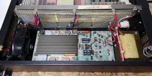

This photo is of the rear power connector and matching cable I mentioned in a previous post.
It is kind of difficult to imagine that I never noticed this before. And it actually does work to deliver power to the rear 20 slots of backplane. Ignore the hex head screws just to the right of the connector. I am trying to.
Well, I went out to get some lunch and then do my daily walk and when I got back I could think of nothing else that needed checking so I plugged it in, flipped the breaker on and turned the key.
No drama! load address works and all bits of the PC work. pressed examine a few times and there is stuff in memory. Do it again and the same stuff comes back so memory is mostly working.
At 200 I deposited a 5200 and then made sure it was there. YES! Load address, clear, continue, and it is doing a JMP to 200. Amazing. Changed the program to a 7001 followed by a 5200 and that works too. That is an IAC followed by a JMP back to the IAC. I can single step and watch the AC increment. For all the problems with the physical stuff the CPU seems to be mostly working. Here is a current photo.

"It is kind of difficult to imagine that I never noticed this before. And it actually does work to deliver power to the rear 20 slots of backplane."
Well, I've made comments about these connectors in the past... This was the power connector in my 8/M.
Also a 20 slots, the machine wasn't even fully loaded with boards. :rolleyes:

I didn't realize an 8/m used a different connector on the power supply. Perhaps that is where they got the housing and just moved the pins around. I guess I better look that up.
The red wire with the insulation burned off is the +5? Looks like it got a bit toasty. The black is probably the ground and it looks like it is maybe 14 gauge?
That style and size of pin when brand new will only carry about 15 amps, 20 in a perfect world.

I didn't realize an 8/m used a different connector on the power supply. Perhaps that is where they got the housing and just moved the pins around. I guess I better look that up. The red wire with the insulation burned off is the +5? Looks like it got a bit toasty. The black is probably the ground and it looks like it is maybe 14 gauge? That style and size of pin when brand new will only carry about 15 amps, 20 in a perfect world.
The pin types in the connector are probably the same. When new, the contact resistance was very low. But after years oxidation and less contact pressure can rise the contact resistance. This can generate massive heat. The red wire was the +5V indeed. I have put an extra set of wires for GND and +5V from the 5V capacitor on the power supply directly to the back plane. So now the wires are double. I've done the same in my 8/F and also in my low model PDP11/10. Never had any problems again.
When I see your picture I think I see the also a little oxidation...
Here is my 11/10, it has the same power supply as the 8/F or 8/M. I've added an extra set of wires between the 5V capacitor on the power and the backplane. Originally I had a voltage drop of 0.7v between the power and the backplane. When I added a card I had to adjust the power supply. That is not what you want. Now the 5V is rock solid on the back plane...
