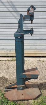

I am still trying to work out how best to fit the handles to the boards using brass rivets ( see Attaching DEC Handles, the Right Way ).
