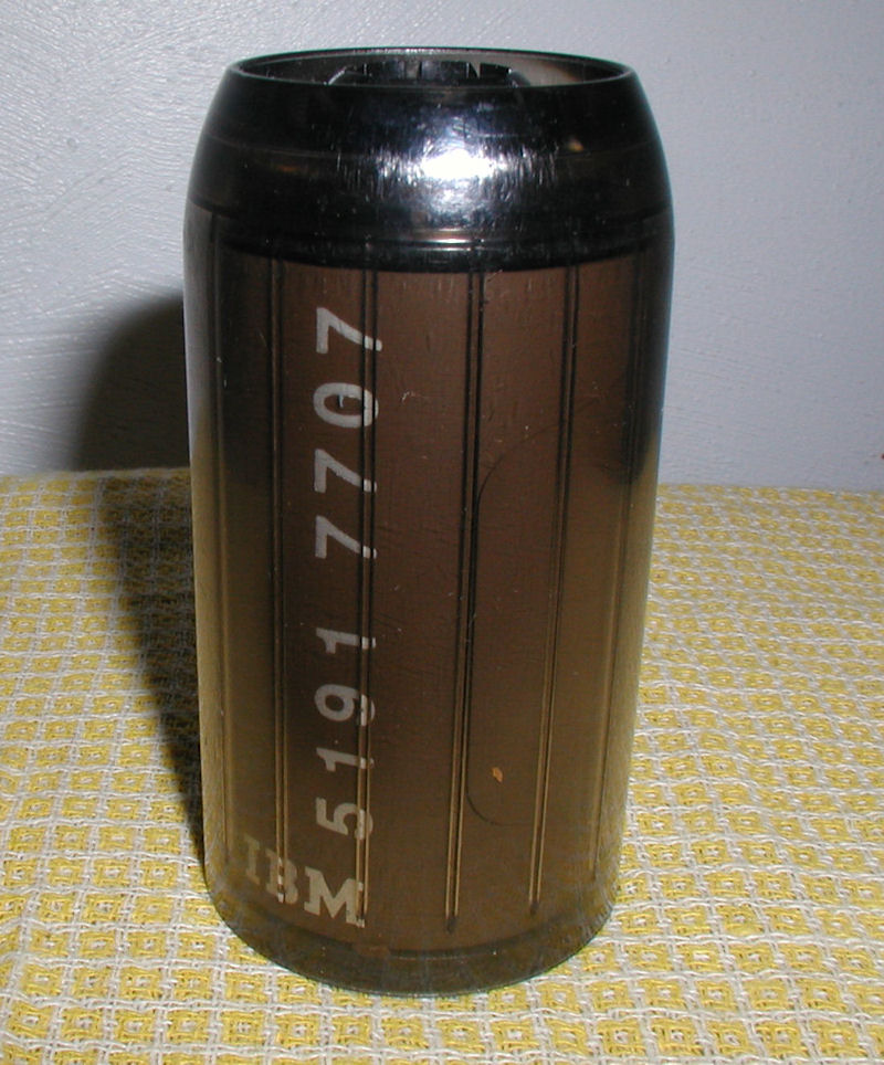

What is this? 2-3" tall

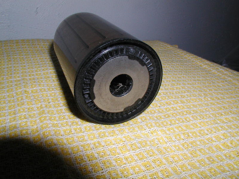

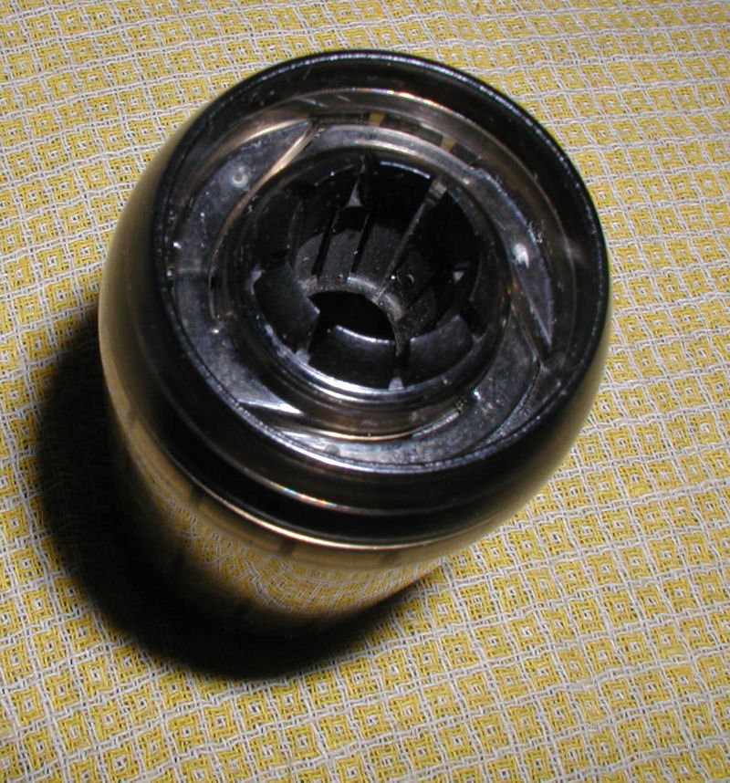

Do you have a picture of the top and bottom? It is similar to the ink bottles we used for the Business System 6/40, but this isn't one of them. This looks to be twice as tall.

Has anyone figured out how the 3" x 770" tape was wound and read from the cartridge? I would guess it would need roughly 150 turns. Perhaps it worked like an 8-track, in an endless fashion - but I can't see how you would get a 3" wide tape to curve over the top?
