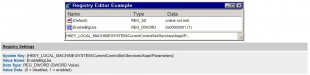

48-bit LBA issues
If you have an older PC that is BIOS qualified to use a LBA HD, but still has a problem with XP or W2K, the following workaround may help. You need get into the registry and perform a simple edit as specified below. Note: backup your registry first.
