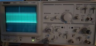

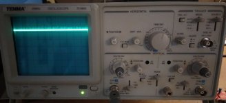

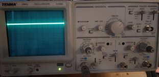

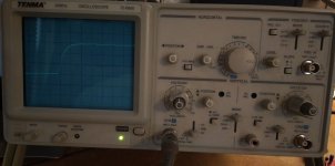

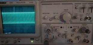

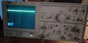

Probably the next thing is to get some more objective data from the oscilloscope. Can you monitor the following pins please:
ULA (IC1):
Pin 12 /INT
Pin 33 /IORQ
Pin 38? /MREQ - Try IC2 pin 19 instead (I can read that pin number on the schematic!).
Pin 3 /RD
Pin 2 /WR
DRAM (say IC6):
Pin 3 /WRITE
Pin 4 /RAS
Pin 15 /CAS
ROM (IC5):
Pin 20 /CE
Pin 27 /OE
I am looking for signs of life at this point in time.
The other thing to try would be to forcibly reset the Z80 CPU by temporarily connecting IC2 pin 26 to GND and removing it again.
The reset circuit is just a simple resistor and capacitor. It 'should' work - but is very crude...

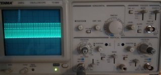

So that strange second wave form on IC1 pin 6 seems to happen while the cpu is in reset. If it lingers I am assuming its stuck in reset. Using your method of IC2 pin 26 to ground resets the system but we get different results. Sometimes the waveform clears up sometimes it has the second form while in reset, sometimes that waveform lingers.::BELOWIC2 pin 6.jpg
ULA pin12 is pretty hard to get a clear image of BELOW:ULA pin12.jpg
ULA pin 33 Showing high at 3.3V with lots of ripple BELOW:

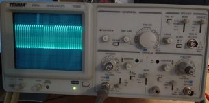

ULA pin 38 and Z80 pin 19 look the same:
ULA pin 38 below:
Z80 pin 19 BELOW:
ULA pin 3 Below:
ULA pin 2 showing high at 3.5 volts below
More in the next post. Let me know if I should be taking a photo with X10 on to clear things up.
Ok Next is DRAM IC6 pin3 about 3.3V below:
DRAM IC5 pin 15 below:
DRAM IC6 pin 4 below:
Ok onto the ROM IC5 Pin 20 is giving me pretty much nothing.
ROM IC5 pin 27 is giving me +1.22V on my voltmeter not much to see on the scope.
With the voltmeter I am measuring +0.25V

David, if you read post #23 you will observe that the DRAMs have been removed, tested as good and reinstalled in sockets. It would appear as though either the DC/DC converter died of its own accord, or the hasty replacement of all of the transistors and capacitors resulted in the converter malfunctioning. I assume that Verault has checked the DRAM after the converter was repaired? Is this correct?
The DRAM will power up with initial rubbish, and this rubbish can be variable until the CPU has initialised the contents. If the Z80 CPU is not clearing the DRAM, this will account for the rubbish display.
The DRAMs appear to have /RAS and /CAS activity in READ mode (no writing).
What I find interesting is the (seemingly) lack of signal activity on the ROM - implying that it is not being read correctly by the Z80 CPU.
Can you recheck the following signals on your oscilloscope please:
ULA pin 34 (/ROMCS)
Z80 pin 19 (/MREQ)
ROM pin 20
ROM pin 27
One pin of the ROM should be connected to /ROMCS, and the other ROM pin should be connected to /MREQ.
