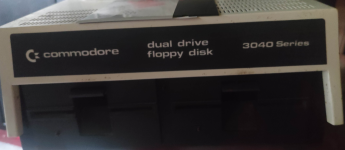

Good evening guys!!!!
I am desperate now!!!
I connected my 3040 cbm dual drive to working 2001N Pet but when i turn on, i can see only the two red leds...central led remains off :((

It might not be the drive which is faulty.
It is not unusual for there to be a fault on the IEEE port on these old PETs and you will not notice it until you try to connect something to the port. The machine can have a faulty IEEE port and work perfectly well in other respects.
Now that the machine is working well enough to run BASIC commands there are some simple checks you can do using the BASIC POKE and PEEK commands to get an idea of whether the IEEE port is working, because the port has the unusual ability to read the state of its own output lines.
I'm sure others will be able to tell you the exact method, but for now, with the drive NOT connected, try this:
POKE 59426,0
PRINT PEEK(59424)
Result=?
POKE 59426,255
PRINT PEEK(59424)
Result =?
...Remember the address you're PEEKing is not quite the same as the address you are POKEing.
...59426 for POKE
...59424 for PEEK
That was quick! OK, so those results should have been 0 for the first check and 255 for the second check.
If we translate the first result you should have obtained to binary you have:
00000000
And if we translate the first result you actually obtained to binary we have:
00100100
Counting from data bit 0 at the right hand side to data bit 7 at the left hand side we can see that bit 2 (which represents '4') is '1' instead of '0', and bit 5 (which represents '32') is '1' instead of '0'. If you add 4+32, this gives you '36'.
So the bad news is that this is telling you that you have a fault on two of the data bits on the IEEE port and the data bits in question are handled by two separate buffer ICs, UA7 and UA8. What is more, the simple check you did just now did not check the UA9 buffer, so there may possibly also be a fault with that buffer as well.
There are further checks which Dave & company can guide you through to narrow down the exact fault and rule out the 6520 - for example you can try swapping another 6520 into the UC6 position to see if that changes the results of the check but in my experience so far the cause of problems like this has always been failure of the MC3446 buffers - however they are quite expensive and difficult to find so any work you can do to prove that they are responsible for the fault before ordering replacements would be good.
