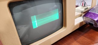

I recently picked up a Columbia VP, one of the early IBM clones. The CRT in it displays but it's not giving a usable picture (see attached image). I've discharged the high volatage in the anode and removed the CRT board. Inspecting the caps and other components, I don't see anything obviously leaking/burnt/damaged. I get 12 volts at the connector for the board when it's disconnected. I believe I was getting 8v when it was connected to the board, I'll have to double check. The ground and 12v don't appear to be shorted at least.
Does anyone have a service manual for these or can give me a direction to go in? I'd like to get this this up and going.
Although I'm not well versed in electronic components, I'm technically minded and can follow along if someone's willing to guide me.
I only have a multimeter to work with but might get a scope and try to learn how to use it. I've been watching a lot of Adrian's Digital Basement and can see that scopes can really expand the diagnostic capabilities with these early computers.

You have horizontral deflection with foldover and while I can see retrace lines in your your green box either you also have poor vertical deflection or weak high voltage.
Absolutely start with a complete analog board recap. Just because they don't look bad doesn't mean they're still 40 years old.

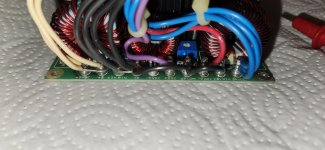

Very nice, I've also got a Columbia Data Product VP. Mine also has an issue with the CRT board - the linearity coil on the CRT board got smushed (the CRT came loose in shipping and damaged it, but fortunately somehow didn't crack the CRT itself).
I'd be interested in seeing a photo of your CRT board to see if it differs from mine.

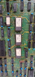

Also, just a BTW, if this has a different BIOS rom than the ones that are archived out there, a dump would be appreciated. A later update supposedly fixes compatibility with VGA cards. (VP uses the same BIOS as the desktop 1600 MPC)

As far as the BIOS goes, I wouldn't hold my breath. My unit appears to be a very early build. It has a very low serial number (317) and the power cord is non-removable. I am curious if there are other differences in the hardware.
Here's the CRT board:
Looks like the BIOS is a disappointment:
(see attachment)
Ok, not too surprised about the BIOS. I think most units out there have this version, but thought I would ask.

At a glance, that CRT board looks about the same as mine.
One small difference, next to the green wire on the board that runs to the CRT socket, yours seems to have a pluggable pin for a ground wire while mine has a black ground wire soldered on to it (that the other end is screwed on to one of the grounded mounting screws on the power supply)
I'm thinking that is redundant ground, but if there was a wire to it, make sure it gets connected.
As far as electrolytic capacitors, the catch is ideally you only want to replace things if you really suspect there is a problem. BUT when electrolytic capacitors start to go bad, they can create seemingly unrelated odd issues that are hard to track down. You risk damaging things by replacing caps willy-nilly.
With tantalum they either short or go boom, so not as much of a headache.
Also, just FYI that one huge low capacitance-value capacitor by the linearity coil has no direct modern electrolytic replacement. It has been suggested to use (ceramic?) capacitors designed for use in microwave ovens. But from the looks of things, I doubt there is a problem with that one.

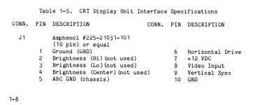

Speaking of the CRT, it turns out the Kaypro machines used a very similar CRT by the same manufacturer. I've been reading though this thread. I wonder if they are interchangeable? They look like they use the same connector and the model number is very similar. And you are correct, that's a pluggable pin for the ground. The other end connects to one of the power board's mounting screws. I wonder if that indicates that they had problems with the pluggable design.
I started searching for other machines that use this CRT and that might have better documentation. I found the Intel iPDS 100 also uses it and a gentleman named Mark Ogden has a site where he has archived service documents. Luckily, Intel supplies the pinout of the CRT edge card in the Field Service Manual, under the CRT specifications section. Using that as reference, it looks like the VP uses the same pinout. The VP doesn't make use of pins 1 and 5 (Ground and Chassis Ground, respectively). Interestingly, the ground we've been discussing that is pluggable on mine and soldered on yours, looks like it could have been on pin 5, since the Intel pinout shows that as "ARC GND (chassis)". I wonder why they chose not to use the connector pin for it? Perhaps there's other components in the way. Here's the pinout:
Colorized with VP wire colors by yours truely:

The video signal to the CRT board should have the same sync timing as composite video. I'm a little surprised they did not include a composite output port for an external monitor on the machine. The Compaq Portable did.

So, on this CDP, you don't have an intensity line. Instead you have an analog "video" line that, I think, should have two different voltage levels depending on intensity. With the above circuit you would just get black and white, no in between, but that should be enough for testing.

So would the 3 wire video signal coming from the board be CGA, or is this some other format meant specifically for the CRT? I'm trying to understand what I have and what I don't have. Thanks for all of your help!
Are we sure this isn't just straight composite? (Granted that only should require two wires, but the third could just be a "monitor turn-on" signal or something.) I don't have one of these machines but the photos I've seen indicate that the monitor can output CGA in shades of gray, which it would not be able to do if this was a fully digital connection. I assume this three-wire connection runs to some intermediate board upstream of the monitor's 10-wire edge connector? I don't suppose anyone has any good photos or (better) a schematic of that board? It may well be a composite add-on for the monitor chassis.
An in-between possibility might be that the three wires are an analog "intensity" line, composite sync, and a ground, IE, not quite regular composite, but close. If that were the case you might be able to run an alternate monitor with little more than some mixing resistors.
