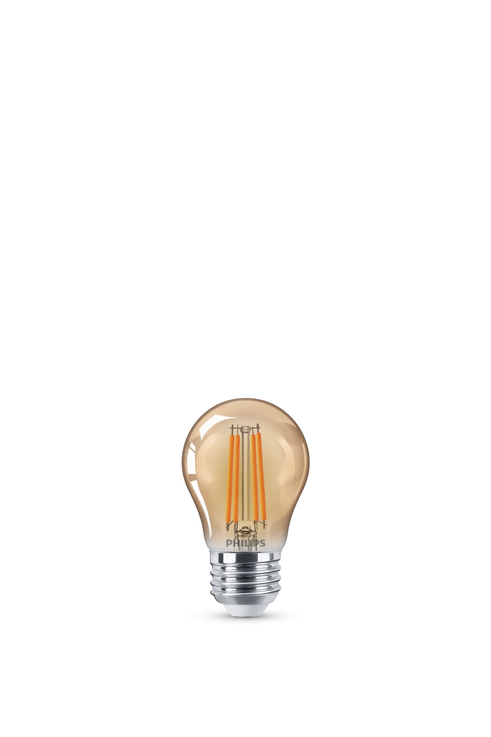

I like to use the "vintage look" LED bulbs outside. They have a gold tint to the glass, and the color temperature is rated 2200K IIRC. I like the orange light outside better than blueish since it doesn't seem to take your eyes out of night vision mode as much.
Something like this:
