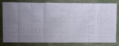

So now that I am resigned to making my own control panel for my H200 replica I have made a very modest start on that, most of my time having been in demand elsewhere. Fortunately my ex Honeywell field engineer friend, having recovered from his seriously shattered leg injury, got into his loft and found there an original control panel fascia, so he created from this a full size template showing where all the holes for the buttons are. This ensures that my panel will be an accurate replica regarding the exact positions of the buttons.
However, this fascia was clearly from a later machine in the H200 series as the earliest design H200, such as the one in the previously mentioned film Billion Dollar Brain had a slightly different layout. This template corresponds to the H120 panel in the Rhode Island Computer Museum but the same layout was used for all later machines in the H200 series such as the 1200 and 2200. My own website https://honeypi.org.uk/ shows a CGI representation the original H200 panel which I intend to build. One evident difference in it is the use of a single toggling Address Mode button to switch between modes 2 and 3 whereas later machines used individual buttons to switch to modes 2, 3 and 4 according to the capabilities of particular machines. However, a more subtle difference is the position of the buttons at the right of the panel. On the original machine as on my website the sense switch buttons were in line with all the other buttons on the bottom row and the Display/Enter buttons above were logically placed halfway between the rows of buttons to which they referred. In contrast on the template above and the RICM H120 panel the sense switch buttons have been moved a third of a row down and the display/enter buttons a third of a row up. This was done to provide space for a second row of sense switches on some machines and the modification then appears to have been applied on all subsequent panels including the more basic H200 according to the assembly schematic.
An extremely subtle change in the control panel was that the button originally labelled "Central Clear" as on my website was later relabelled "System Clear". This was no doubt done to make it clear (!) that the button actually affected all the peripheral devices in the system rather than the CPU as the only thing that could be regarded as "central" in this respect was the control panel itself within the system! When I was working on the H200 back in the 1960s I never understood why that button was labelled "Central Clear" and evidently nobody else did either so it was renamed, but my replica must remain faithful to that early era.

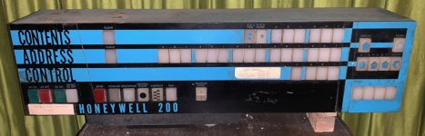

Great news! Just when I was knuckling down to building a control panel from scratch today I received an email from a chap near Atlanta Georgia telling me that he has one that I can have! From the pictures it looks to be in good condition as well with all the original buttons in place. We just need to sort out shipping it to the UK but Atlanta Airport is a key shipping hub so it can't be that difficult and it's even on the right side of the USA. Keep tuning in for the next exciting episode of The Honey Pi Project.
RobS
Sep 28, 2012
274
Kent, England
I am totally amazed at how quickly things have moved. Within a single day this chap has told me that he has a control panel and shipped it to me, so I now have a tracking number and estimated delivery time next week. Just to confirm this he even sent me a photo of the panel at the FedEx office awaiting packing. What a saint! Break out the bubbly!

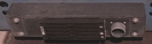

Wow, looks like a full panel. bit of a clean and that's that part done. Does it have the insides?
From the photos it appears that it may never have been opened and it still has the original connectors on the bottom so it was probably simply unscrewed and unplugged from the machine when that was being dismantled and then taken home by someone as a souvenir conversation piece. In a photo of the back at least two or three of the four driver PCBs can be seen through the ventilation slots so these clearly haven't all been pulled out either. If the machine was just being scrapped then it is likely that the panel was still in working order at the time as there were other far more temperamental key components in the machine that could have caused it to fail terminally if indeed it did.
The machine's most sensitive component was probably the magnetic core control memory which ran at four times the normal speed for such technology by using pairs of cores in a differential arrangement so that they didn't saturate and completely change polarisation as normally happened in core memories but instead just changed their level of magnetisation relative to each other. The working temperature of the machine had to be just right for this to work and at such high speeds the cores could easily overheat and burn out, which actually happened at the company where I worked. It is probably no coincidence that the machine was designed by Honeywell, the company that made its name by marketing thermostats! In his notes on the machine's design the chief designer wrote that the entire machine was built as cheaply and simply as possible except for the inclusion of this relatively sophisticated control memory, which gave it its enormous speed advantage for the price over the competing IBM 1401. However, it was also the machine's Achilles heel.
The truth is that I don't have the schematics for the panel, so it will take me a while to work out how to use it. If it only had the switches but not the other logic then I could just construct my own drivers and wiring without having to find out so much about the original, so either way I'll be happy with it as really I just wanted to avoid all the metal bashing needed to make one.

That does look like it has been stored well. only a little bit of rust on the top and good as new.
I cant remember reading it so sorry if your having to repeat yourself. Are you looking to have this at home or give to your local computer centre etc?
