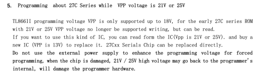

M2716 need a programming voltage (VPP) of 25V, which the tl866ii-plus can't do. If I remember correctly it goes up to 18V.
You need a pin compatible EPROM which can be programmed with lower voltages, another programmer or you feed the 25V in externally (e.g. While bending the vpp pin out). But that is risky and requires timing.
Yep, exactly what I said back in post #157 and is stated in the manual:
A different EPROM programmer or EPROM device is called for I am afraid.
