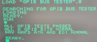

I got the C2N to play nicely. I typed the program in and checked it. All it does is show "END OF TEST", I'll go through it again tomorrow with fresh eyes.
I can see no errors in my code taken from PET and the IEEE 488 Bus (GPIB) physical page 184. I then added (after the screen grabs below) PRINT statements at lines 421,521, 621 and 704 to show which IEEE488 lines were being tested. It never tests the data lines and the code returns nothing useful on the control lines:

I modified the code to actually say that all was ok for each test. Otherwise if you see that result for the first time, it leaves you wondering if everything was ok or not. When its not it reports the error, but the thing is when all is ok you don't know that unless you study the program.
Agree annoying, it's a few PRINT lines to make it more usable. I'll modify that at some point.

I modified the program to report the attached (makes me feel better)
