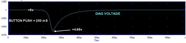

That circuit won't work properly in the actual PET for two reasons:
One is there is no resistor to discharge the capacitor and turn the circuit to its original state prior to the next use of it (except for extremely low diode leakage). So it will only work once for a reset and that function will fail after its first use once the capacitor is charged. Also when the computer is line powered of, after that, re-powering it will take the side of the capacitor connected to the diode to -5V. Its easy enough in the simulator to set the capacitors initial voltage at 0, but you have to consider how it could get back to that state later.
On my PET at least, the minimum resistance value on the DIAG line to pull it low enough, that it is interpreted as a logic low is close to 3.3k, for example a 4.7k won't do it, so modelling the source resistance for that at 100k won't work. This is one of the many reasons I used a transistor to drive the DIAG line, so it can sink enough current to get a solid logic low.
Further to the DIAG line issue as noted (in my PET at least) the minimum resistance to ground on the DIAG line to be interpreted as logic low is about 3.3k. With this resistor in place experimentally, the voltage across the 3.3k resistor is close to 1 volt. Very similar in fact the the voltage required on the /RESET line to be interpreted as logic low, it is less than one volt. It is acting as though the internal pullup resistor in the PIA is roughly about 13.2k Maybe that varies with the brand of PIA IC, not sure.
I have attached some of the simulator recordings of my circuit with the transistor. One other beneficial feature of the transistor (whether the original unit used one or not, we don't know for sure) is that because of the knee of the B-E junction of voltage vs current, the transition of the DIAG voltage from a definite logic high to a definite logic low is only about 60mS so the period of a "logically ambiguous voltage level" is relatively short compared to the slow charging profile of the capacitor. And any voltage on the DIAG line > than about 1V is interpreted as logic high. Actually the ambiguity shrinks to a some 10's of millivolts on either side of the 1V threshold where the DIAG pin is interpreted as high or low.

I took a few more recordings from the simulator. The simulations above were using a 1K resistor for the transistor load, if I altered that to 13.2k for the attached simulations, to better represent what the DIAG line in the PET behaves as (my PET at least), the switching point is a little more sensitive with a slight left shift in the graphs.
Plotting the DIAG voltage with the capacitor's charge for a long push such as 1 second, shows that the capacitor's voltage levels out to 0.95V (as expected) at about 600mS and after that, after the button is released from a long push, the DIAG stays low for a while as the capacitor discharges into its discharge resistor and the transistor's B-E junction too.
The circuit also demonstrates something else, which I knew about from using a transistor's B-E junction as a voltage reference in a switching application. The Silicon signal transistor's B-E junction starts to conduct at around 0.50v and by 0.6v it is conducting significantly, with 0.55v to 0.56v being the figure where the transistor's collector-emitter circuit represents about 10k and this is the actual central threshold voltage for a signal transistor as a switch, especially if its collector load resistance is in the order of 10k. When a silicon signal transistor is in a switch-mode supply application, and its B-E used as a voltage reference with a switching signal, the average base-emitter voltage (integrated measurement) usually measures around 0.55V. This is the way it is in the car Alternator voltage regulators as one example. It is good that the simulator agrees.
To check this, if you set up a transistor like a BC338 in a simulator, grounded emitter, with a 5V Collector supply and a 10k collector load resistor, and put a voltage source in its base, with a series resistance of anywhere from 1 Ohm to a few hundred ohms, you will find that the collector voltage will sit at about 2.5V when the base voltage is about 562mV. (of course in real life that arrangement is temperature unstable due to the -2.1mV/degC temperature coefficient of the B-E junction). In the Alternator regulator though, they cleverly cancel this temp coefficient out by using a series 7.5 to 9V zener diode in series with the base which has a positive temperature coefficient. Lucas built a transistor with the zener diode inside it.
The graphs of course are easily shifted to the right, just by increasing the 4700uF capacitor value.
