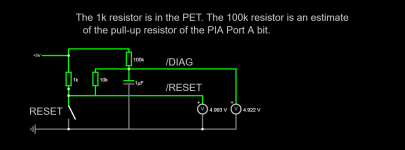

Hi all, quick question, Pronto-PET had a neat little reset switch which on a quick press performed a reset but if you held in the switch it would pull the diagnostic line down and reset the pet into monitor mode. All mounted in a compact box.
Anyone got a circuit diagram for such a reset switch or the best design for a compact circuit?
it’s in a very small box maybe 1.5cm by 3 cm … only connections on the motherboard are pin 22 j4, pin 25 j4 and pin 20 j9

I have built a 2 switch box where when you depress the “diagnostic switch” it pulls the diagnostic line to ground and then you tap the reset switch… that pulls it into the monitor… ideally I would like to replicate the Pronto-PET solution

Ah, Olaf's text makes it now obvious...
You have a conventional normally open pushbutton between 0V and /RESET. The pull-up resistor is on the PET board of course.
You then connect the /RESET signal to the DIAG pin via a capacitor. The trick is to find the correct value of the capacitor to do the magic trick.
Ordinarily, the DIAG pin will be pulled up to +5V (via the internal passive resistors built into the 6520 PIA port A).
Pressing the RESET button briefly will cause the CPU (etc.) to reset - but will not make much difference to the charge on the capacitor feeding the DIAG pin.
Pressing the RESET button for a longer period of time will cause some action on the capacitor. I will model what will happen in SPICE if I get a bit of free time...
When the RESET button is released, the CPU will start executing but (hopefully) the DIAG pin will still be LOW as the capacitor tries to charge up.
However, having just written this - I see I am a little confused about how this is going to work - so I will need SPICE to help me here!

I have used something like this previously with other systems. Will it work? IDK. IF you have access to only the ground line and the DIAG and /RESET lines something like this "should" work, though I am waiting for the electrical engineers of the group to swarm and pounce once I post this:
R1 and R2 are for current limiting purposes, so can be something like 470 ohm, start with larger values and work down till you can trigger a reset condition with a short press. This will depend on the pullup resistors that keep these lines HI normally. IDK what those are. So some futzing is needed. Start with a larger value for C1 and work down, 22uF is a good guess. Large values will require a longer press to trigger the diag condition.
At power on, C1 is unbiased, and both DIAG and /RESET are driven high in tandem by their usual pullups.
A short press causes C1 to charge from /RESET. How fast it charges depends on the pullups on /RESET, R1 and C1. A short press biases C1 slightly, but not enough to maintain DIAG LO long after release.
A long press causes C1 to charge completely at which point the pullup for /RESET will drive /RESET HI, but DIAG is still driven LOW by you holding the switch. So if you keep pressing the system will reset - hopefully in diag mode. The time to reset can then be adjusted by using a larger / smaller C1 value. Releasing the switch at this point does not matter, /RESET is already high, C1 is biased to drive it high and drive DIAG LOW. So basically, "hold till diag" The time constant for the chosen C1 may be very long. So patience.
Also... will this work? IDK.
Copy the attached into https://www.falstad.com/circuit/

x 161 -35 813 -32 4 24 The\s1k\sresistor\sis\sin\sthe\sPET.\sThe\s100k\sresistor\sis\san\sestimate
x 178 -5 626 -2 4 24 of\sthe\spull-up\sresistor\sof\sthe\sPIA\sPort\sA\sbit.

The time constants are a bit too slow at the moment - but the principal is there...
This may not be 100% correct.
At a power-on condition, the capacitor would be fully discharged and would have to charge up via the pull-up resistor of the PIA. As a result, the PET may enter TIM.
I'll keep thinking - and simulating...

Thanks Dave….. I guess the 5v comes from the reset line when it pulls up high on pin 22
Yes, the 5V is the PET +5V and the 1k resistor is the pull-up resistor on the PET.
