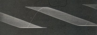

Also, I have attached a very clever photographic recording from a CRT face, created in the 1936 era by Manfred Von Ardenne ( an early televsion researcher in Germany). He created it to visually demonstrate how the TV scanning raster was formed on a CRT's face. It was an interesting method and his permanent recording remains, to this day, in print. I have posted this image on the net before, so "the Cat is already out of the bag" on how he did it. If you don't know it is a bit of a brain teaser.
