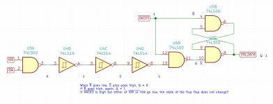

I could not help myself and started on an XTA interface card design. It was all going fine until I found this extra circuitry on the Seagate ST05X card for ~DACK. I must be misunderstanding something because it seems to do nothing. Can someone assist? The blue text is notes I added while trying to make sense of it.
I think I would have to sit down and write out a truth table for the whole thing. Is it there to make sure DACK is de-asserted when a read/write cycle starts (ior/iow goes low)? It kind of stinks of a hack they might have thrown on there to deal with a known implementation bug with particular motherboards or drives.

I plugged it into an online simulator and it does do something. It will hold ~DACK low while either ~IOR or ~IOW are low. I will implement it on my board.

Looking at ISA timing diagrams DACK is supposed to be low until the end of IOR or IOW already. Again I suspect this is a fix for some common(?) bus timing mal-implementation discovered after the drives were built assuming everybody did it right. It’s a shame you probably have no chance of finding out why it’s there without tracking down an elderly Seagate engineer.
Yeah, and the timing diagrams I am looking at (http://www.ee.nmt.edu/~rison/ee352_spr12/PC104timing.pdf) show that DACK should be held for even longer than this circuit is doing. I am tempted to just remove it, but there must have been some reason Seagate decided to implement it. It is very annoyingly messing up my minimal 3 chip design :)

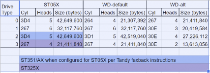

Here is the WD BIOS from my CompuAdd 810 motherboard, which has XTA integrated.
Thanks for this. I spent some time disassembling it with Ghidra and added it to the analysis project here: https://github.com/JayesonLS/8bit-ide-analysis
I learned some interesting things:
1. The BIOS determines the interface address based on the BIOS address. If the BIOS is at C800, the ports start at 320, otherwise they start at 322. I think to support two drives, it would require two copies of the BIOS. This would be the case if two WDXT-150's were installed. Both the BIOS address and the port address jumper on the WDXT-150 (W1 and W2) would need to be changed together.
2. The WDXT-150 has an IRQ 5/2 selection jumper. However, the BIOS reads the configuration from the drive. WD drives have jumper to make this selection. With Seagate drives, I think you would be stuck on IRQ 5. Quite strange.
3. XTA drives only have 2 drive size bits (4 possible sizes). The WD BIOS supports a second set of drive parameters for 8 possible configurations. Which set to use is queried from the drive - I think it might be the "physical/logical" jumper on the WD drives that changes this.
4. The drive parameter tables vary when compared to the ST05X bios. I think this is why the ST351 A/X has so many jumper configurations - so it can be fully compatible with Seagate and WD BIOS'es. Drive info below for future reference.

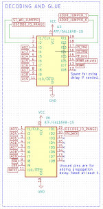

Getting back on topic, I think I will try to finish out the XTA interface card since I have put some thought into it. Plan is to make it configurable as either an ST05X, or a WDXT-150 card. I am going to use a pair of GAL16V8s for all of the glue logic. Keeps the part count down, and the BOM short. Also the least expensive option as far as purchasing parts go - Atmel's 16V8's are about 1.5x the cost of a typical LS logic chip and in this case, do a lot more work. The two 16v8's have a little logic to spare if future feature needs come up.
