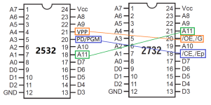

A 2532 and a 2732 are not the same. They cannot be used interchangeably and one setting on an EPROM programmer cannot be used to program the other type either. Three pins are different:
In order to use one type to replace another, you HAVE to use an adapter.
Will you PLEASE stop doing this - it doesn't (or shouldn't) work!
In fact, the programming voltage pin is different between the two devices. Doing what you are doing could well damage/destroy the device because you are supplying a +25V programming voltage to a TTL (+5V) input pin!

I use a TL866 that can do 21V and, using the adaptor Dave posted above, have no problems programming 2532A EPROMS as 2732A units.
I have also some Tms 2532A but i haven't adapter....how can i make an adapter?
A 2532A requires a 21V programming pulse. Check your documents to see if your programmer supports a 2532A...
So, reading back at Hugo's post, this particular programmer does not support PROGRAMMING a 2532A - but it does support programming a 2732A.
Guess what, the image I posted in #1041 (even though it is for the "non-A" variant) is the adapter wiring you require.
2532 <=> 2732 adapter. 25V programming voltage.
2532A <=> 2732A adapter. 21V programming voltage.
There is no difference in pinout between the 2532 and the 2532A or between the 2732 and 2732A (the difference is purely the programming voltage).
