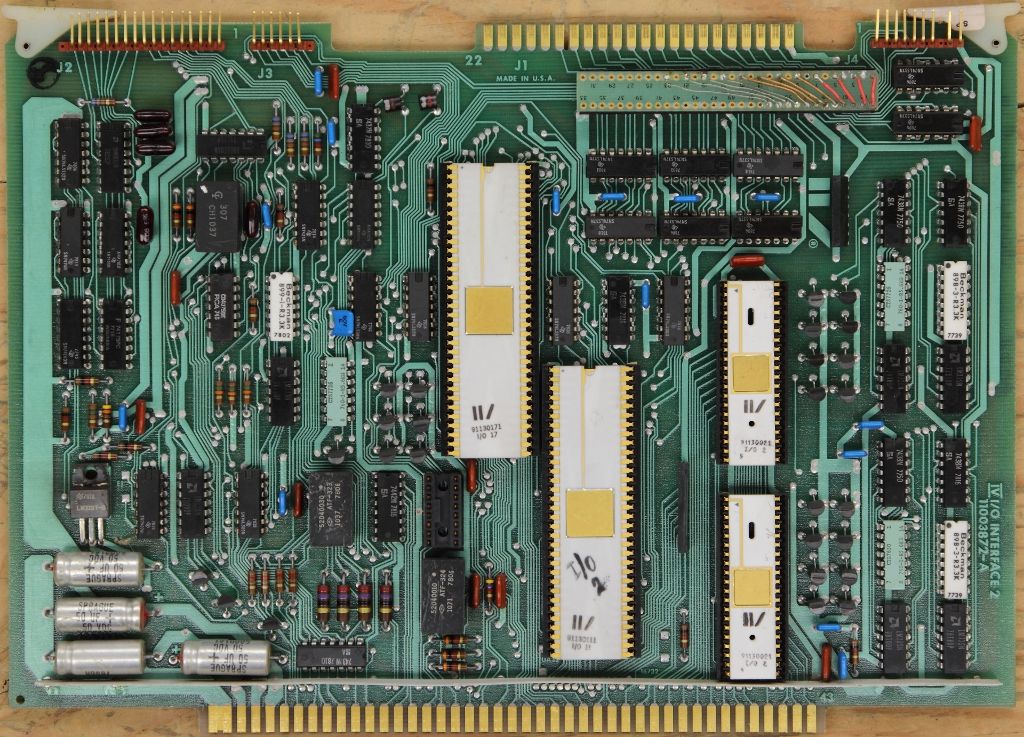

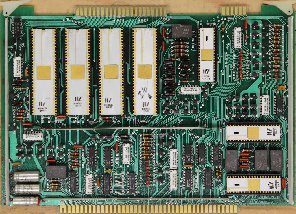

The last major boards have now arrived on loan. The two missing I/O interface boards.
These two boards are the glue that hold the entire system together. Signals from the front panel, the DT, the CPU and the character generator boards all pass through here and nothing works without these. They have been photographed and sent off to Bitsavers, so we now have images of what a complete boardset looks like.
I also received on loan additional cabling that links these two boards to the distribution board and handled the video and keyboard I/O. We do not have wiring diagrams for these so I'll probably make new ones so that it's possible to make more in the future and return these ones. Both boards also have more of those 50v 50uf capacitors so they too need to be replaced. I'm hoping to complete a lot of the preventative maintenance and wiring work by next week and then it's finally time to see if we get life out of the front panel.
Note the DIP jumper headers. I do have *some* of the information on these. These are mainly for configuring the amount of ram, number of printers and other finer details. I have not gone through any of those yet.

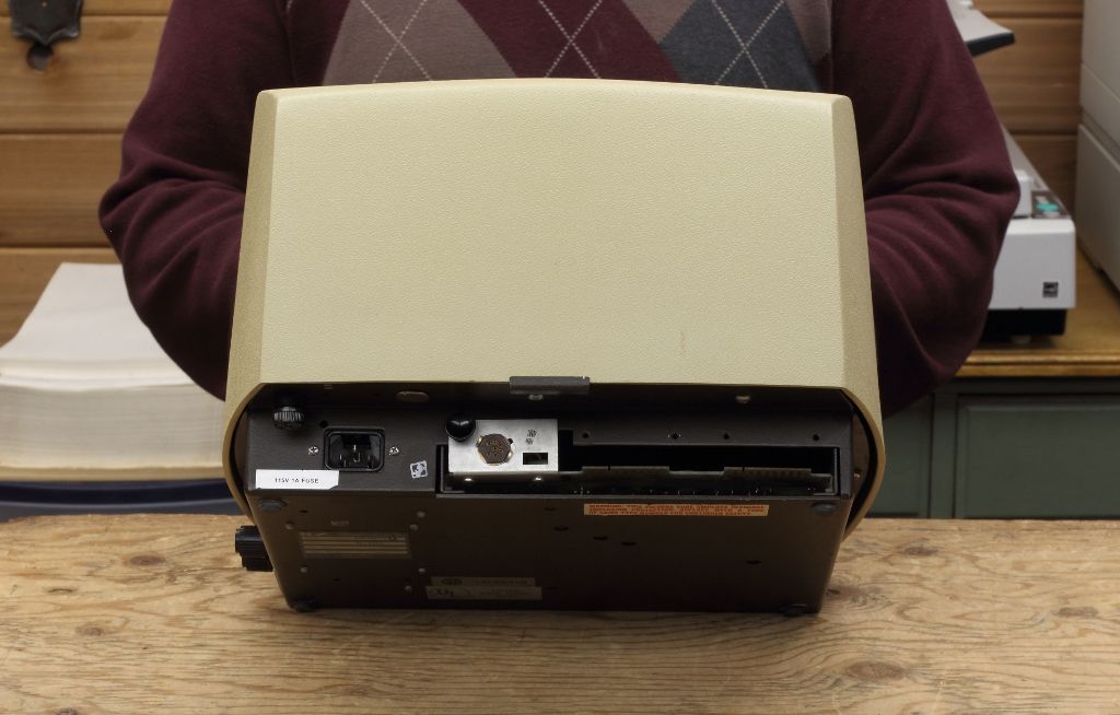

So after about five months the terminal has arrived for pickup in Seattle. I'll go retrieve it next weekend during the Interim Computer Festival.
The next is that after picking he brain of a few folks on the classicCMP discord we were able to narrow down on the printer that Four-Phase was selling and is seen in a lot of their marketing material. Really it should of been obvious but it's a Diablo, more specifically the HyType I and II models. The manual for these printers is available on Bitsavers. The printer did not attach to the terminal because remember, the terminal had no character generation circuit and was more or less a composite monitor. The printer regardless of where the terminal was would have to be connected directly to the computer. With that in mind I went back into the schematics and located the basic diagrams and strapping info for the line printer card. A very simple card with not much on it and which I had living in one of my I/O slots with nasty sunburn.
Interestingly, while the default HyType documentation makes no mention of it as an option, the line printer controller can be configured for either a single-ended 8-bit data bus or a differential 8-bit data bus. Presumably the idea here is that like the terminals which may not be in the same room as the computer, you can run the printer more than 25 feet away from the system. The pinout is also useful in figuring out how the heck this attaches to the funky 25 pin interface the HyType uses. Weather or not this can be adapted to a more conventional parallel printer interface I've yet to really sit down and check.
As for printers in 2025, HyTypes suck. I can only assume that Diablo loved the Winchester connector because both the data interface AND the power supply used them, so they were not just keeping this stupid connector exclusive to their drives. >:T

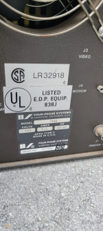

So it turns out those printers were not only special to four-phase they had the undocumented terminal passthrough and not the Line Printer interface, so they were indeed very very special and very much designed for my system.
I negotiated with the seller who by then was going on three weeks with no interest and wanted to get rid of them pretty quickly, I negotiated a deal for one shipped as-is because it's already in the carton, got the shipping quote, agreed on a $50 price and then it turns out they didn't have Paypal. Just Venmo and Zelle. Neither of these are available to anyone outside of the United States and after frantically asking around for SOMEONE on the west coast to close on the deal he got fed up with my BS and stopped talking, so I still don't have a printer. :C
Edited: adding photos form the Facebook listing and DM's.
Like, Brandon if you are reading this there's no hard feelings but I'm throwing money at my monitor and I got nothing that's compatible with your payment methods unless you want something obnoxious like a wire transfer or a money order.

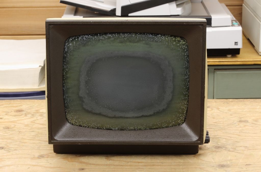

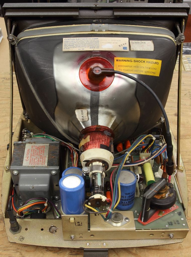

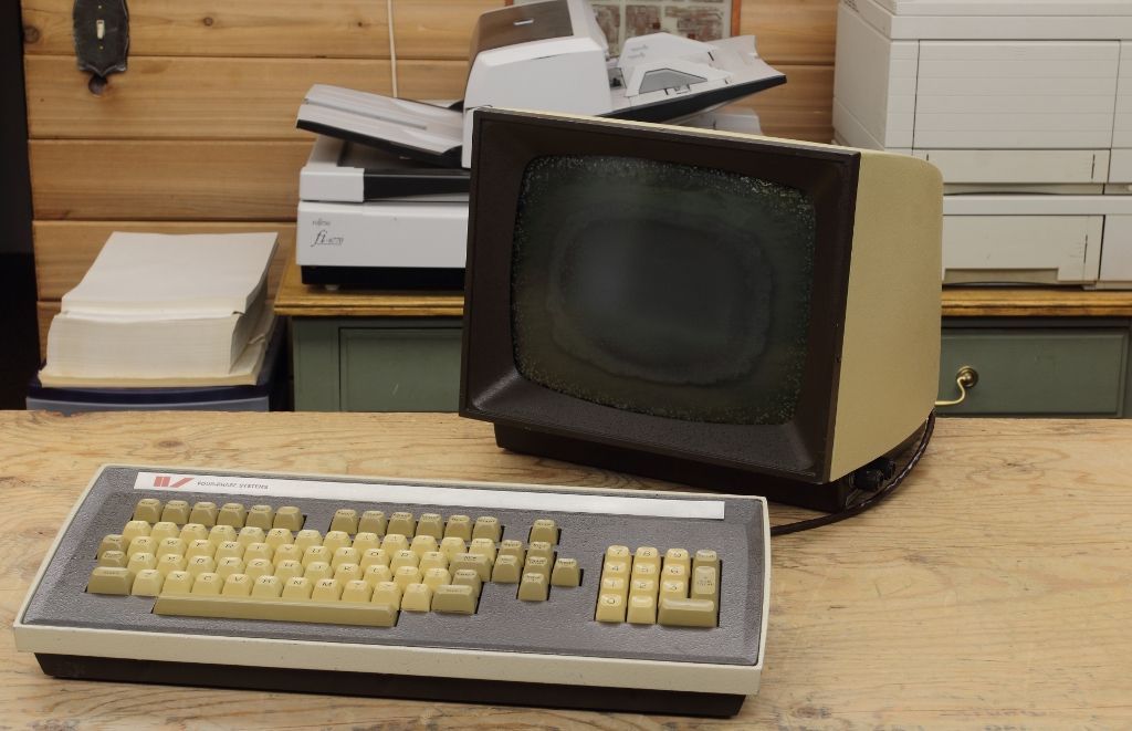

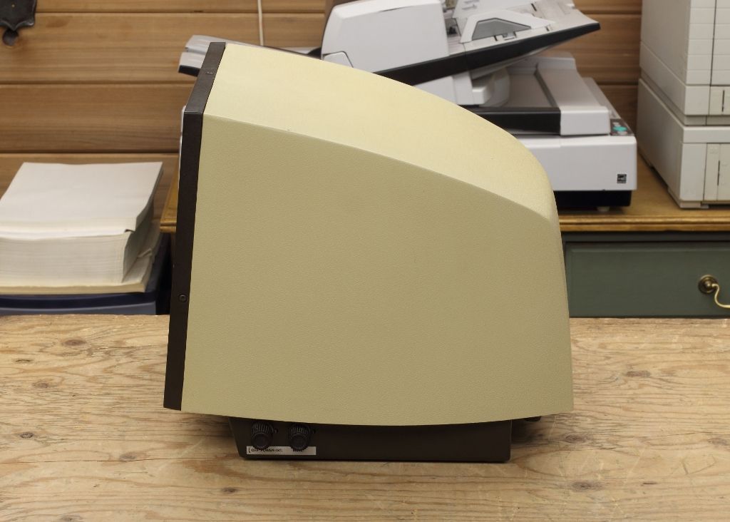

Folks we have a terminal.

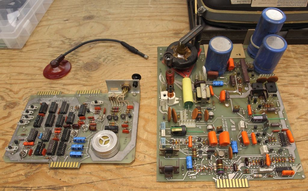

Excluding the nasty cataract I still need to remove it has a P39 green phosphor similar to the IBM 5151. This is the heaviest monochrome monitor you will ever pick up because the entire front bezel and base is made of metal while inside also contains a very large transformer. As you can see from the back the terminal connection is a 20 pin double sided edge connector that allows all signals to pass through and up to four terminals to coexist on a chain and share the same video signal. Each terminal has a mostly separate keyboard which almost does not interact with the display at all however if you opted for it, the logic for a light pen can be installed inside the keyboard on its own pin header and an extra port on the back of the keyboard is the pen input. The video signal is analog and quite close to composite, not not exactly I think. while the schematics we do have for the monitor does not state the signal is anything special, supplying video through pin 10 and a return ground it sees something but cannot sync to it. Rather than begin fiddling with all the adjustments right now I'll wait until we are ready to bring the system up.
The analog board and the terminal board are removable on edge connectors. Both took a recap and the larger caps were separately tested and found to be good.

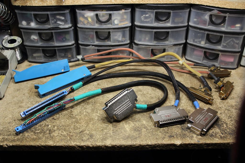

After months of procrastination and sourcing the correct parts I've also now made copies of the two cable harnesses that connect the I/O boards to the mezzanine distribution board. the originals can now be returned to MITA. I have also made pinout sheets for both cables since they were missing for the other documents uploaded to Bitsavers.
One more cable needs to be made and that connects the I/O board to the power supply, then we are finally ready to put it all together and turn it on.

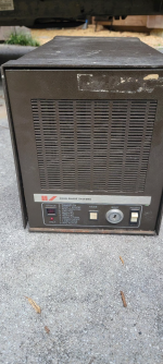

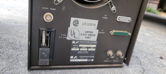

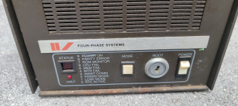

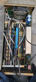

So here's one that got away. I can't tell the origins of the photos or the listing but it got picked up and advertised by the etsy-clone resellers. One place still had the listing up but I'd hesitate to try and buy it if everyone now 404's.
This is a "7161" Looking at the front you have a power switch, a keylock for booting the box and a 7-segment LED indicator for status codes or if the processor has halted. The back has ports for a standard terminal with a Winchester plug, two BNC jacks for printers (Cool, I wonder what type of interface THAT was) and what is probably a synchronous serial port for an external modem..
The real magic is inside where we can see it has a switchmode PSU, two RAM boards and variant of the CG, DT and processor boards. It's new enough that they were using socketed EPROMS, judging from the photo.

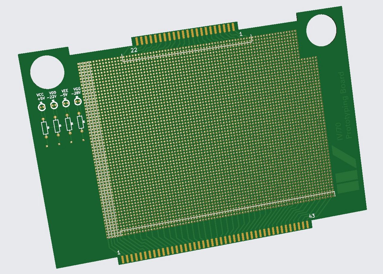

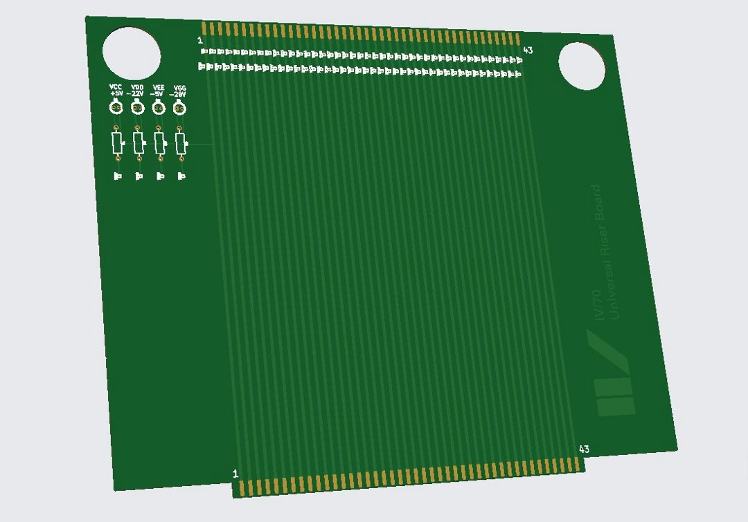

On a whim I decided to draft out an idea for what boards it might be practical to build for now and with the help of someone WAY more skilled with CAD than me we now have designs for prototyping boards and riser boards so we can probe boards while they are loaded in the machine. Probably the first new boards designed for a Four-Phase machine in 40 years.
Very simple boards with finger holes rather than plastic latches so they can be more easily pulled out with locations for LED's to indicate what each power rail is doing.
