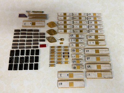

God DAMMIT ebay. Four-Phase is a saved search and told me nothing. Not a single damn email or notification and I was at a company event last night when it ended.
Ran it manually just now and boom, there's TWO listings it didn't tell me about in Vernon. What the hell did it not understand about "if the description says "four-Phase", tell me regardless of location".
Edited: son of a $#%#$% it's in Vernon. It's the town right next to me.
Well I can try asking them if they have anything else, like the boards these were stripped from but looking more into the seller it's just another Thrift Shop Vulture and probably doesn't even remember what store they found it in.
