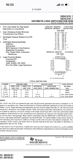

A 74181 is an ALU, it cannot replace a CPU. It is a useful chip alright, but despite the Boolean logic it performs, it cannot on its own run a sequence of operations in the sense that uP can, it is better told what to do , either by a uP, or other hard wired logic to control it.
It makes a great IC for a calculator, or any time you need to perform the basic math functions on binary logic. It is better regarded nowadays as a "microprocessor support IC". But granted, it is an impressive IC. I have a number of these in my IC's collection.
You can of course make a simple uP free digital computer, with these to demonstrate 16 binary arithmetic operations on two 4 bit words. I think there have been some internet projects demonstrating it in this application. But these days an average programmer can code that into a fairly low generation uP, and still have resources to make it display data on a screen and even make the screen interactive.
> It would be funny if the 74LS181 caught on instead of the microprocessor.
For me it's not the same level of integration and it was not as fast as you would imagine. They had to be put in serial plus a carry-ahead CI, plus registers to buffer the output, so it was hard to achieve more than a few megahertz.

Serial? Few megahertz?
A delay of 44 ns should make it possible to run at 10 MHz with good selection of registerfile. Using the S variant improves the situation yet more.
A variant of 74181 (S or standard) were used in most TTL PDP-11.
> 44ns
Yes that's what is in the datasheet for LS181 for 16 bits with carry-ahead.
But that's only the time to propagate a result from inputs to outputs.
That's not a fair comparison with microprocessors.
A fair comparison would include the instruction register, the instruction decode circuit, the pipeline registers, and all buffers for input/outputs on data and memory busses.
The PDP-11/70, one of the last TTL PDP-11, took 2 µsec to process a single operand instruction.
This includes the time to load the instruction, plus the time to process it.
In the document linked they allude to a duration of 300ns or more for EF time.
