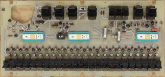

While talking to the local Four-Phase guy about the issue of 2N3643's going pop he asked I go over the power supply again suspecting either one of the rails have gone out of tolerance or there's a considerable amount of ripple. I mentioned I had already checked this but he said to go through it again and more importantly, load and adjust the voltage rails to spec. I'll need to talk to him regarding if I should load and adjust each rail one at a time or load them all at once and adjust them. As you can see on the first page there are multiple adjustment pots underneath but on my first pass beyond making sure the rails were in tolerance I didn't dare touch them so he'll be helping me double check them next time I'm on the coast.

Bit of a stretch here but would anyone have a list of known good slot allocations? Still thinking about how we had parts overheating and popping when certain boards were in play and how the backplane while a passive bus does have custom wired slots. Up to now I've only gone on assumptions that boards are correctly inserted and that matches the labeling beside each slot. Looking at MITA's system (which does have different boards, just to make this fun) There ARE boards in places different from mine. I'm wondering if I'm running into the same issue the DEC people have when you drop a normal Unibus or Qbus card into a modified slot. I have reached out to him in the hopes he can send me a manifest of what board are arranged where in his systems, but beyond that I don't have any official word on how Four-Phase configured the boards.

After realizing my card arrangement was wrong earlier this week I had time last night to generate a new slot list of my system compared to the one pictured at MITA and it's clear now there's major problems.
-The RAM boards are in the same locations. I still cannot confirm if these are 96K or 48K boards.
-The DT board is in the correct location
-MITA has only one CG board with unknown intensity control, so that machine can do 8 terminals rather than 16, which is fine
-There's a mystery board I cannot identify in the "MP" slot and whose visible component layout does not match any of the schematics
-We both have the IV/90 CPU extender in the same slot. His front panel lists the IV/90M, so I can't question its location
-There appears to be two boards for the I/O Interface (marked I/O INT 1 and 2 on the chassis) that connect a lot of wiring to the terminal distribution board and mine are both missing. I can make cabling for them but looking at how the AL1 processor board interfaces in the schematics it looks to really want these boards.
-The Driver/Receiver board is in a different slot (Remember how this was popping parts on the DT board whenever it was installed? This is probably why)
-The tape interface seems to be in the same location
-There's a line printer card in one of the last slots and another card I cannot identify as its layout is also not in the schematics.
I've reached out in the hopes I can get a better idea of what cards and their part numbers are installed but if the I/O interface subsystem is entirely missing that's a pretty major problem because either it means the I/O bus or the terminal subsystem is electronically isolated from the CPU or worse, the glue to make the system work at all is missing. IF we are very lucky I can still bring the system up with a front panel and only a front panel but that's it.
